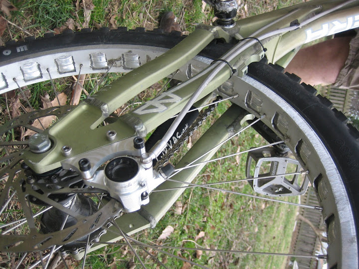

Dang! Posted December 31, 2008 Author Report Share Posted December 31, 2008 (edited) Jason222- the reach is @ 675mm if I remember correctly.FYI- the rider in the above pictures rides an Ozonys Cannibal. His comment after 3 days on the caelifera was:"this feels more balanced and tucks really well, my side hops got bigger...it also sits so well on the rear, and gets there so easily that I thought something was wrong with it the first time I brought it up, it just stays there... the rearend is really stiff, much stiffer than mine." The Ghost (otn) Edited December 31, 2008 by Dang! Quote Link to comment Share on other sites More sharing options...
Tall_Rob Posted December 31, 2008 Report Share Posted December 31, 2008 Hello Dang.I like concept behind your rear disc mount but personally not to sure on the idea still. Having a completely cnc'd dropout that incorporates the disc mount in my opinion would be a lot stronger and stiffer. If a bolt was to work itself loose, i can imagine the adapter writhing against the frame and flaring the area where it will attach.This is the same reason why i don't use an avid brake on the rear of my bike. You have to run an adapter which allows for more stress points and areas for flex. I will always use a Hope or similar mounting caliper.I look forward to receiving this frame and putting it through some rigorous testing for you. If would like any more input or ideas, please message me.Other than that, i have checked out the blogs on your site. The frame looks great. A Comfortable geo and size. I can't wait.Regards,Rob Larkins Quote Link to comment Share on other sites More sharing options...
Dang! Posted December 31, 2008 Author Report Share Posted December 31, 2008 Hello Dang.I like concept behind your rear disc mount but personally not to sure on the idea still. Having a completely cnc'd dropout that incorporates the disc mount in my opinion would be a lot stronger and stiffer. If a bolt was to work itself loose, i can imagine the adapter writhing against the frame and flaring the area where it will attach.This is the same reason why i don't use an avid brake on the rear of my bike. You have to run an adapter which allows for more stress points and areas for flex. I will always use a Hope or similar mounting caliper.I look forward to receiving this frame and putting it through some rigorous testing for you. If would like any more input or ideas, please message me.Other than that, i have checked out the blogs on your site. The frame looks great. A Comfortable geo and size. I can't wait.Regards,Rob LarkinsThanks Rob- in truth you're correct- any mechanical connection has inherent potential for play. Same as the connection of your Hope caliper. The beauty is for those interested, I have no problem making this a permanent connection. But for those who want to try disc or rather the purity of rim brakes only. it's as simple as two bolts. Cheers and happy new years! Quote Link to comment Share on other sites More sharing options...

Dang! Posted December 31, 2008 Author Report Share Posted December 31, 2008 AH, sorry about not realizing the 3 frames bit. It seemed as though you were only going to be sending out 1 frame by the way people were writing. 675mm is about what I'm running now on my ZHI, seems a bit too long for my size...would be nice to see one with identical geo to the hydroxx. That frame is perfect IMO. I liked your initial frame design, but the welds on it really turns me off. If you could get that sorted out it would make these frames more enticing, especially at that price.Well there are two ways to accomplish better welds: Have someone else do it (read more expensive) or wait as my welds get better one frame at a time. Quote Link to comment Share on other sites More sharing options...
