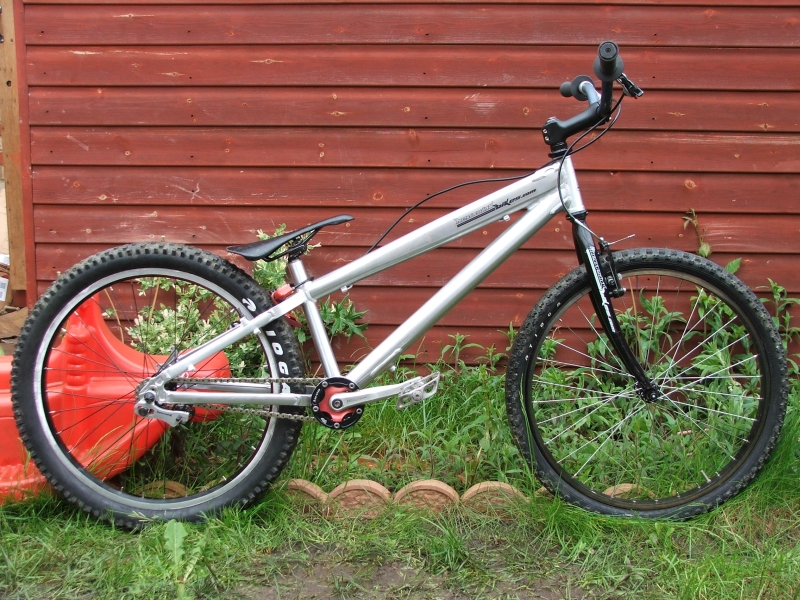

Endohopper Posted November 21, 2008 Report Share Posted November 21, 2008 I think Mr.Heatsink experimented with 24" wheels in an obviously stock Base TA26 frame , although no indication on how it felt / rode . Looks pretty good , though . Quote Link to comment Share on other sites More sharing options...
J Trials 31 Posted November 21, 2008 Report Share Posted November 21, 2008 Would vee's be hard to setup with this type setup? I know maggies would be almost impossible. Quote Link to comment Share on other sites More sharing options...
spaceman Posted November 22, 2008 Report Share Posted November 22, 2008 Would vee's be hard to setup with this type setup? I know maggies would be almost impossible.Mr Heatsink managed to put maggy on hisTopic here: http://www.trials-forum.co.uk/forum/index....c=79304&hl= Quote Link to comment Share on other sites More sharing options...
