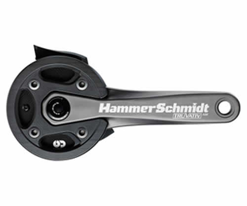

Jake Beach Posted November 11, 2008 Report Share Posted November 11, 2008 (edited) After reading the article about the truvativ HammerSchmidt in the latest issue of MBUK ( issue 231) and reading that it could be ideal for single speed jump bikes making it 2 speed. Do you could we start using them on 26" and mabye even 20" trials bikes? You could run gears without having a mech to bust up.ThanksJake:) Edited November 11, 2008 by Jake Beach Quote Link to comment Share on other sites More sharing options...

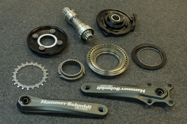

manuel Posted November 11, 2008 Report Share Posted November 11, 2008 I guess you could think though, (if its any good) the price of a chris king, a pair of decent cranks, and a bash, as ultimatly thats what it could be replacing on your bike. Oh and possibly a gear setup.I guess you need to take into account a pro2 is cheaper etc.Anyone know how it works? Is it in anyway similar to current internally geared rear hubs?isnt it based around classic sturmey archer gear hubs ? I think i read that somewhere. there is an exploded view on the truvative website though Quote Link to comment Share on other sites More sharing options...
Tom_ Posted November 11, 2008 Report Share Posted November 11, 2008 Ahh yea, I see.Comes in 24:38or22:36 apparantlyIn the 22 tooth it turns the sprocket once per rotation, however in the "overdrive" it turns the sprocket 1.6 times per full crank rotation.Pretty clever. The sturmeny archers wernt up to much really, and engagment is apauling, but im guessing this will be far superior. Will be interesting to see it tested, and really put through its paces. At £400 a pop your gunna want it to last. Quote Link to comment Share on other sites More sharing options...
haydon_peter Posted November 11, 2008 Report Share Posted November 11, 2008 Here are a couple of videos showing how it works: Freecaster VideoMpora Dirt TV VideoIn both videos the bash is clear so you can see the internals. There are other videos on the internet if you have a look around but they are all very similar.I don't know the exact weights but the system isn't meant to be much heavier than a regular chain ring set-up.I'm not sure how happy I would be to bash it on the trials bike when messing up a move. For 'freeride' you are not going to bash the chain ring anywhere near as hard or often (seeing as your only really protecting the chain ring from rocks that might flick up off the trail and for the odd occation you might clip a log or rock)Not relevant for trials bikes but full suspension frames are going to have to be designed specifically around the Hammersmidt otherwise they will bob and have excessive pedal feedback. Quote Link to comment Share on other sites More sharing options...
manuel Posted November 11, 2008 Report Share Posted November 11, 2008 HB - "hit it on a rock - it'll take it" ... We will see .... Quote Link to comment Share on other sites More sharing options...

mr kenny Posted November 11, 2008 Report Share Posted November 11, 2008 from what i have read and seen of the hammersmidt its a basic planitarium cog/ gear set= loads of engagments and feel due to there being 4 smaller cogs running round the larger ones- a bit like planets rotating roung the sun(lame desprition i know!)this is exactly the same as sturmey archer use in thier hubs...would you run a sturmey archer?nor me!rowan will be good to see how that goes(you might even have it when we ride together!)kenny Quote Link to comment Share on other sites More sharing options...

craigjames Posted November 11, 2008 Report Share Posted November 11, 2008 there's a few people making them, g-boxx, suntour, nc-17, all work on the same sort of planetary gear system. i wouldnt compare it to a sturmey, more to a rohloff as thats the level of quality. dont know what it would be like for trials use, cant imagine the internals would appreciate the bashing they'd get from some riders.......also i think the nc-17 version, which is licensed from another german manufacturer who has been making a similar product for hybrids for years now, uses a button where the crank bolt would be to shift rather than a shifter... seems pretty cool, less cables, less on your bars, better for streety trials? Quote Link to comment Share on other sites More sharing options...
