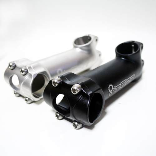

Crazyman Posted November 8, 2008 Author Report Share Posted November 8, 2008 Yes of course, i'm uderstand you Thanks for good post!And you are right with geo of stem. I'm find special stem Neon Bow for bow frame: http://www.crazybike.ru/forum/download/fil...8&mode=viewGeo: 175mm/35 degrees and as trialtech it's made from 2014 aluminium. Quote Link to comment Share on other sites More sharing options...
