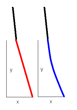

Dannoo Posted November 4, 2008 Report Share Posted November 4, 2008 curved and straight bladed forks are the same rake (wheelbase is the same) so it just comes down to looks.How is it possible for them to keep the same wheelbase?I just cant understand it The bent one HAS to make the wheelbase longer hehe..Please explain it to me!//Danno Quote Link to comment Share on other sites More sharing options...
sstein Posted November 4, 2008 Report Share Posted November 4, 2008 How is it possible for them to keep the same wheelbase?I just cant understand it The bent one HAS to make the wheelbase longer hehe..Please explain it to me!//DannoStraight blade have angled shoulders to bring the legs forward so you are getting the same wheelbase. Quote Link to comment Share on other sites More sharing options...

AdamR28 Posted November 5, 2008 Report Share Posted November 5, 2008 How is it possible for them to keep the same wheelbase?I just cant understand it The bent one HAS to make the wheelbase longer hehe..I have attached a picture to explain - X and Y are the same in both forks, just the legs are welded onto the steerer tube at a different angle. Quote Link to comment Share on other sites More sharing options...
