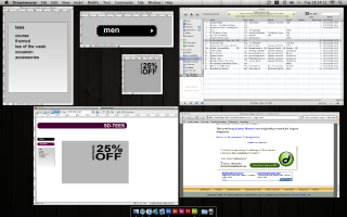

RR_Trials Posted October 28, 2008 Report Share Posted October 28, 2008 (edited) Well, I am just making this thread as i need some help with my design using Dreamweaver. For a start, people like JonMac and Simon (i think)... What editors are you using to build website?My problem is that I cant seem to get my images and text exactly were I want them on the page. I finally managed to get the '25%' picture roughly along side the other 3 images. Now from what i can see there is no way to line the top of that image up with the top of the 'men' button.Secondly I cant get the 3 images on the left to move closer together. I used a table and managed to get the distance right but then I cant have the '25% image on the right.I'm thinking i need some sort of WYSIWYG editor but I thought dreamweaver should at-least allow me to place images and text were i want them. Edited October 28, 2008 by RR_Trials Quote Link to comment Share on other sites More sharing options...
