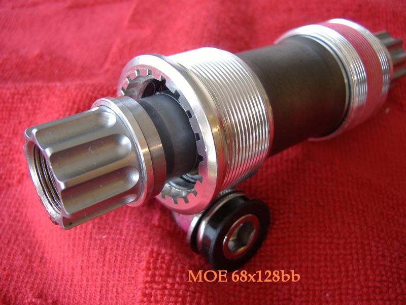

Can I quickly ask why, in the above picture, does the stopper ring (or crank-stop) not extend into the flute of the spline at all? I thought the ISIS standard accommodated for this by ensuring that the ring goes about half way along the radiused end section of the flute. From the looks of the Moe BB it will royally rape your cranks the first time you put them on making them as saggy as a saggy thing.

  monkeyseemonkeydo said:
Yup :).

Hats off, your a good hatchet guy.
Might I suggest that we recall FSA, MONTY and and few other brands for this alleged mass ruining of cranks because the ring does not extend over rounded end of spline. Oh yeah....forgot.... its because it is a non issue.

  Onzaboymark said:
My FSAs had that stopper that stopped the cranks from just mashing onto the end of the splines, I'm pretty sure?
Yes, of course they did. Some of the models have the ring begin at the end of the spline and some before the end of the spline. I agree, too far back and it would be useless. However, since the leading edge cranks (specially soft ones made from 6061) that goes toward ring/stopper..... the thin corners quickly mold themselves to the end of the spline upon first installation.
Fascinating discussion we are having on an issue that is....well, as stated above....a non issue. Theoretical failures of others are an interesting way to market.
