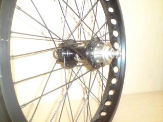

hey guys. I am the person who modified the hub for ste racca (steve carradus). it is a normal hope pro2 trials rear hub. I took the drive shell off and cut threads into the cassete splines and made a stainless steel locking ring for the sprocket. I then machined down the axle, drive shell and outside spacers to bring the hub's total length to exactly 116mm. Built and trued the wheel. jobs a gooden :rolleyes:

was gonna say, it doesnt look like the one that we have been wokring on at hope, looks ok though, nice job
Looks brilliant, but did you machine both the spacers down? You wouldn't be able to use the disc mount. :(

Most of us (well me, anyway) were commenting on the fact that you wouldn't be able to use a rear disc with it.

yeh i don't see why some people are crying over the rear disc mount like
i did this with intention of using it personally..i use rear maggie so it's good for me
but things have changed over the 6months it was gone and now i havnt even rode it and it's for sale as part of my full build GU
Im not sure whether a disc could be used but quite simply if u run rear disc don't use this wheel eh :D
