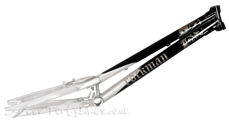

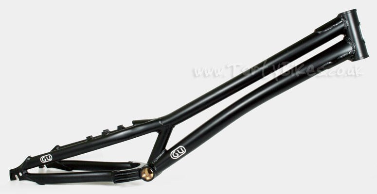

Dannoo Posted September 4, 2008 Report Share Posted September 4, 2008 (edited) Hi there..Im about to buy some new stuff, and first of all, frames! I have thought of either the Rockman ISIS or GU LE 08I found both on tartybikes, and stole the geo specs from there...How would these 2 compare against each other? Lets say If I was about to have all the same components on either of the frames... How different would they feel, and what moves would be easier/harder, and why? If we forget about the different prices, and just focus on the specs of the frame.A friend of mine has the gu le frame, so I have tried that one.. and love it!The rockman has a higher BB, and a slightly longer wheelbase.Im more of a streetrider than natural,but most often Im just building "sections", with pallets, and for me its hours and hours of fun...Allright, here are the 2 geos..RockMan ISIS:Wheelbase: 1100mmChainstay Length: 380mmBB Rise: 45mmHead Angle: 71 degreesCentre of BB shell to top centre of head tube: 680mm---------------------------------------------------------------GU LE '08Wheelbase: 1080mmChainstay Length: 383mmBB Rise: 40mmHead Angle: 71.5 degreesCentre of BB shell to top centre of head tube: 660mm (26")Thankful for tips and ideas! //Daniel Edited September 4, 2008 by Dannoo Quote Link to comment Share on other sites More sharing options...
Greetings Posted September 4, 2008 Report Share Posted September 4, 2008 The LE is a really nice frame, haven't had any experience with the RockMan frame yet.Personally I'd choose the LE due to the head tube angle. The frame will feel slightly more manageable and flicky. It's also got quite a balanced geometry which makes for a good all round frame.Having said that I wouldn't have either of these. Consider a GU ST or Czar long if you haven't yet. Quote Link to comment Share on other sites More sharing options...
Ash-Kennard Posted September 4, 2008 Report Share Posted September 4, 2008 id take the gu personally Quote Link to comment Share on other sites More sharing options...
cai Posted September 4, 2008 Report Share Posted September 4, 2008 GU the lower the bb the better in my opinion, and I hate 'mod-style' dropouts - they just annoy me So the Rockman wouldn't be ideal... Quote Link to comment Share on other sites More sharing options...
The Duck Posted September 4, 2008 Report Share Posted September 4, 2008 I would have been pretty on the fence, but as everybody else has said LE, I'm going to say Rockman Light, longer, nicer looking in my opinion (minus stickers), horizontal dropouts which I love. Don't like the headangle though on either frame. Would have to get Koxx forks with either, especially with the rockman... Quote Link to comment Share on other sites More sharing options...
gu trials Posted September 5, 2008 Report Share Posted September 5, 2008 i have a mod gu le and it rides really nice but i would go for rockman for a good looking bike (colours etc) or for it to ride good a gu Quote Link to comment Share on other sites More sharing options...
Dannoo Posted September 5, 2008 Author Report Share Posted September 5, 2008 My current frame has 1065mm, the GU 1080mm, and the rockman 1100mm.I think the GU felt great getting up and keeping the balance on the rear wheel..Will that feeling be lost if I were to have 2cm longer wheelbase?or does the 45mm mm BB compensate for that? 5mm higher bb than GU LEAnd would the 4.5 cm increase from my current frame, make it feel terrible? Quote Link to comment Share on other sites More sharing options...

Mark W Posted September 5, 2008 Report Share Posted September 5, 2008 I'd go for the GU simply because Rockman are total dicks for calling that frame the "ISIS", in it's not ISIS at all, unless you put an ISIS BB in there... Quote Link to comment Share on other sites More sharing options...
Jason222 Posted September 6, 2008 Report Share Posted September 6, 2008 (edited) I ride a GU LE. Mine just happens to be better than the rest, because Mr Barton test rode it Would be nicer if it was longer. Stem/bar on mine needs to be changed. Run a koxx or meta fork OrLook at the GU ST Edited September 6, 2008 by Jason222 Quote Link to comment Share on other sites More sharing options...

basher Posted September 6, 2008 Report Share Posted September 6, 2008 Dont forget that the actual wheel base and bb rise of the rockman will change if you use any other forks other than koxx. The wheelbase will be 10mm longer and also the bb rise will be higher as most forks have a longer leg lenght compared to koxx. Quote Link to comment Share on other sites More sharing options...

spaceman Posted September 7, 2008 Report Share Posted September 7, 2008 (edited) I have tried Mr Rockman's Rockman bike 2 weeks ago. I have never ridden the GU before, so this isn't really a fair comparison. I'm not really good at giving reviews though.Despite the long wheelbase, the bike "feels" short. Honestly it's my second or third time trying out a stock bike cos most of my friends ride mods. I'm 174cm and thin, and it does feel a little high for me (maybe I'm just not used to riding a stock). Edited September 7, 2008 by spaceman Quote Link to comment Share on other sites More sharing options...
