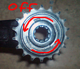

AdamR28 Posted August 24, 2008 Report Share Posted August 24, 2008 As long as you have 7mm of thread you will be fine (the cranks should have 12mm, the bashring is 4mm, so you have plenty).To loosen: Quote Link to comment Share on other sites More sharing options...
Rusty190 Posted August 25, 2008 Author Report Share Posted August 25, 2008 Thank you Adam! However...I didn´t succeed very well, it´s a really tough job getting it off... tried vice, +some heat, tools+long pipe, didn´t help... I will hand it over to my local bikes serviceman as I think I just will break the wheel... =) Thanks Quote Link to comment Share on other sites More sharing options...
AdamR28 Posted August 25, 2008 Report Share Posted August 25, 2008 Yes, it will be VERY tight, when you pedal it tightens the freewheel on... you need to bolt the tool into the freewheel, put the tool in a large vice, and then use a 1m long pipe to twist the crank arm away from the freewheel... does that make sense? Quote Link to comment Share on other sites More sharing options...

Rusty190 Posted August 26, 2008 Author Report Share Posted August 26, 2008 (edited) Yes, it will be VERY tight, when you pedal it tightens the freewheel on... you need to bolt the tool into the freewheel, put the tool in a large vice, and then use a 1m long pipe to twist the crank arm away from the freewheel... does that make sense?YES! =) that makes sense! I did get it off weehoo =) The bolt through the crank and the freewheel helped a lot! No hand needed pushing down the crank or the tool while trying to twist. I found a 2,5 m long pipe to twist it off, what a feeling! Now the bashguard is mounted, seem to fit well!!(I went to my local bicycleshop, only selling racers though, so he didn´t had the best tools for the job =)Thanks again! Edited August 26, 2008 by Rusty190 Quote Link to comment Share on other sites More sharing options...
