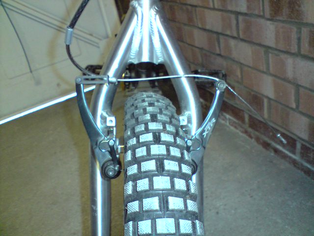

SaC-PrO Posted August 14, 2008 Report Share Posted August 14, 2008 I was out riding the other day and as i pulled my front brake it pulled out of my forks and took the threads with it. I run four bolt to v adapters so i was wanting to no if there was anything that i could do so that i dont have to stop riding until I get myself some new forks. Quote Link to comment Share on other sites More sharing options...
Jitters Posted August 14, 2008 Report Share Posted August 14, 2008 Sorry to hear you're without your ride for bit. Search for threads about installing helicoil kits. The process is cheap and has been gone over more than a few times recently. That'll get you back up to snuff in no time!Cheers! Quote Link to comment Share on other sites More sharing options...
Julius Czar Posted August 17, 2008 Report Share Posted August 17, 2008 My friend has a t - pro and hes just had his back mounts heli coiled, and there working perfectly.so a helicoil kit is the best bet for this problem. Quote Link to comment Share on other sites More sharing options...
jack14366 Posted August 19, 2008 Report Share Posted August 19, 2008 (edited) Can't you just tap and die it ? Not an expert on the subject but when my threds go that's what I do , but not sure if they do one as big as a fork .but its worth going to halfords or any shop like that an enquirer about it this way you don't have to buy new forks.hope you get on ok with it Jack Edited August 19, 2008 by jack14366 Quote Link to comment Share on other sites More sharing options...
forteh Posted August 19, 2008 Report Share Posted August 19, 2008 Helicoil kit Quote Link to comment Share on other sites More sharing options...
abtrials Posted August 24, 2008 Report Share Posted August 24, 2008 get some proper v adaptors not them mission ones, then just use a longer bolt all the thread wont bee buggered, even if it is just use a nut at the back of the forks, i have a set of v adaptors if you are interested pm me Quote Link to comment Share on other sites More sharing options...
