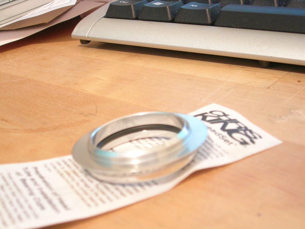

Since I'm not authorized I can't post in the other forum, and I can't PM you.
The easiest way to tell the fake headset from the real is the upper cups bearing seat. The real one is a one-piece job with an o-ring inside it, the fakes use a split bearing seat and are covered by a conical cap (two separate pieces)
I have a couple of Kings in front of me; if you need clarification I'll take a picture.
Tristan
See attached picture....
You can see the bearing seat is all one piece and there is an o-ring grove at the mid-point. As far as I know King headsets are the only ones like this.
On the knock-off headsets the logo and the bearing seat are two separate parts.
