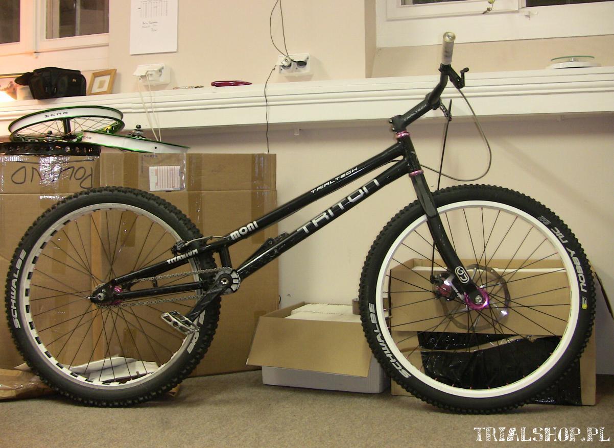

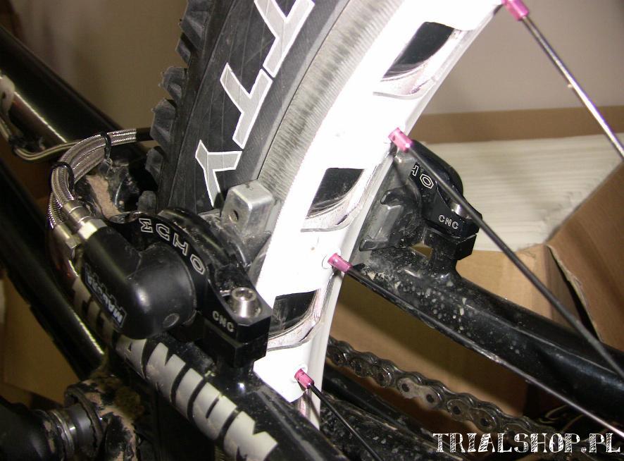

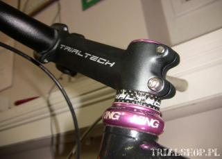

Here she is, 4 days before a 14 day natural ride up in the mountains. Hasn't been in this good condition for months, wheels have been rebuilt, tyres changed, hubs and headset serviced, all important threads loctited into place and various parts changed to Trialtech ones, including some bolts. Was going to run a pair of the HSB Yellows, unfortunately my frame won't take pads that are thicker than 10mm inc. the backing :( There goes my one chance to use some different pads - been running the same Cousts for 2 years now!
The bike rides like a dream, pretty confident it's reached a stage where I won't ever want to change it unless I try to improve the geometry with another Triton project.

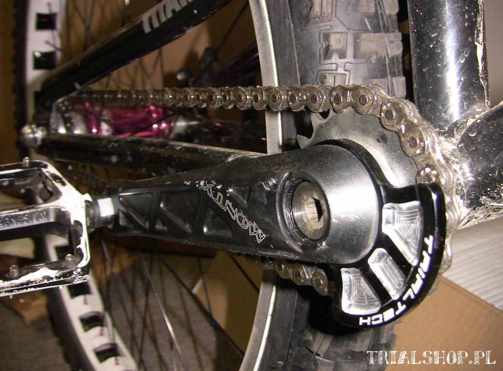

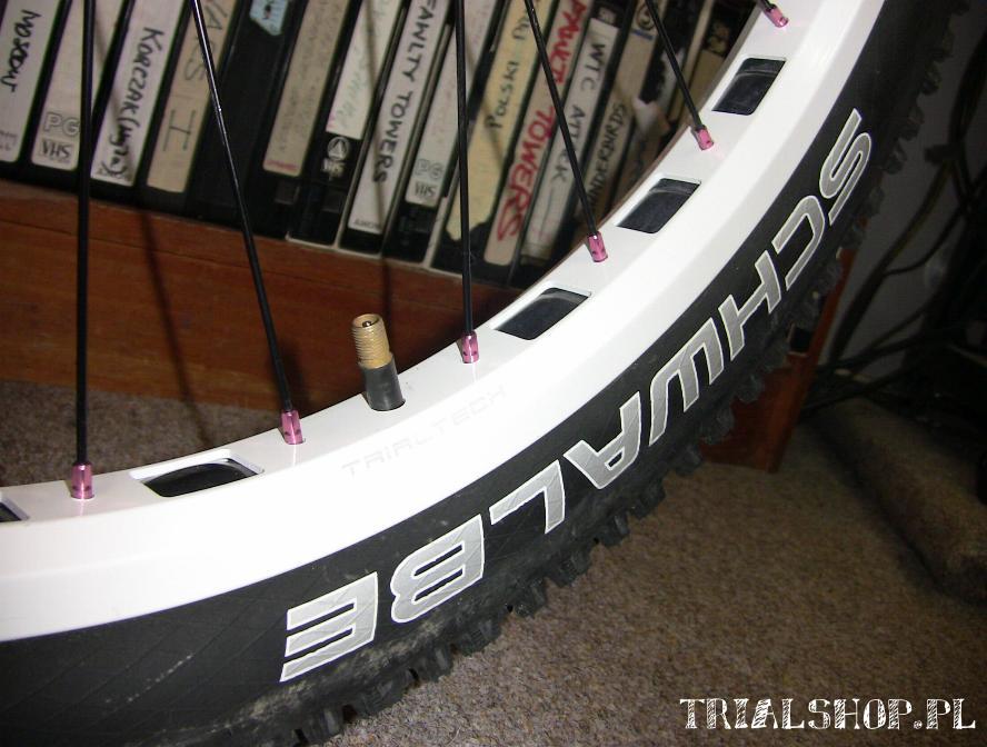

For those interested, bars are 221Ti Montys extended to 740mm, gear ratio is 18:17, cranks are 221Ti 158mm. Rear rim is a modified BT. The lot weighs around 10kgs including a massive rear inner tube.
18:17 must be soooo light to ride
man, loving the look, so nice
My mate had it, it was light but its not bad. That was with 170mm cranks though.
Notice hes running like 158mm montys which means it will be stiffer than on a traditional stock with 170mm cranks.
That does look SOO nice though, wish my bike looked that good/light.
Think that one is 1100wb +50bb and 380cs, not sure on the reach and headtube angle though. Its a custom geo for inur :)
Geometry is:
378mm CS
1091 WB
+45mm BB
72deg head tube
I also remember him saying he could get them stays from 370 to 390?

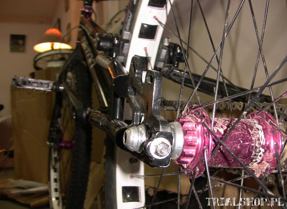

That was with a strange gear ratio, now use 18:17 which gives a chainstay of ~373mm. But yeah, the dropouts are really long, can easily get them to 390 but the bike then needs a disc brake. Would like to try a 73* head tube, lower rise and longer front end sometime in the future but for now this is perfect :)
Rear rim is holding up well, hoping to see some rear Trialtech square hole rims in the future.

So what's the furthest in you can get that wheel then?
But that's the problem with custom frames, you always fancy something different even if it does ride amazing.
