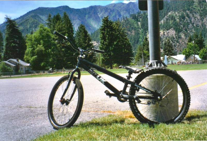

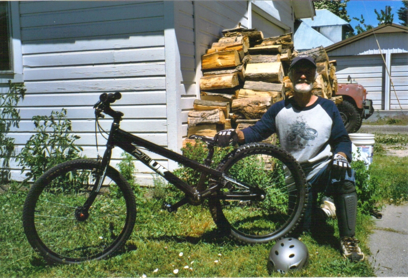

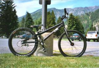

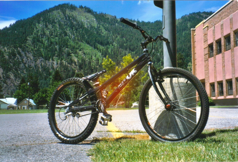

Heatsink Posted July 18, 2008 Report Share Posted July 18, 2008 Hi,I was very pleased to receive photos of a 24UK Mk2 build today. This is a bike built up by Thomas Magee in Leavenworth, Washington State, USA, to the following spec:Fork: Pashley/Leeson from Mr. HeatsinkHeadset: FSA The PigStem: 70mmx20degrees (out of the parts bin)Handlebar: 28” with 3” rise (new but really cheap)Grips: BMX styleBrakes: Avid SD7 V-brakes with Heatsink CNC backings and padsBB: 68x113 square taper Crank set: Truvative 175mm arms, 22t chainring with BlackSpire GrannyGod bash ringPedals: Odyssey triple cage (cheap)Seat: Sella ItaliaFront wheel: Rhyno Light rim (29mm), AtomLab bolt on hub and a 2.3 "Kenda K-Rad tireRear wheel:Alex DM24 rim (32mm), Hadley 72 p.o.e. through bolt hub, Kenda Kinetics Stick E 2.6 tireRear Mech: Shimano 105 road short cage with six speeds (mix and match)Rear Mech shifter: old Suntour friction shifter (new but cheap)Those forks are specials where the Vee bosses were rewelded 1" lower by Clive Leeson. Forks owned by me for quite a while and I wasn't sure if I should let them go. Great to see them being put to good use again!Some further information from Thomas:I've always felt that personal health shouldn't be sacrificed along the way (during life). I used to do a lot of rock climbing and hiking. But I trashed out my knees and was practically unable to walk. So I was fortunate to have both knees completely replaced. It was bike riding that kept me going. Now my legs are my best part, so I am really enjoying learning a new way to use my body and stay in shape.Just so you can know me a little better: I'm now age 70, obviously a novice rider, and I do wear my pads!Thomas, you're an inspiration to us all! Steve Quote Link to comment Share on other sites More sharing options...
