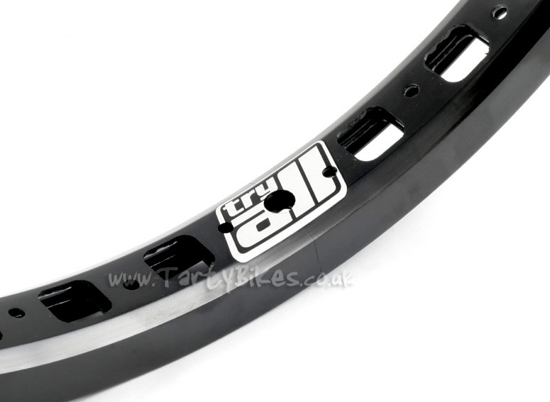

Sam Nichols Posted July 11, 2008 Report Share Posted July 11, 2008 (edited) Quote from Pijin..K-124 aka Try-All aka Koxx aka Money-grabbers aka Trials company aka Some Clueless French Dudes aka Dominique Hermance have hit the nail firmly, 100% on the head by producing just what BMX needs:Finally a bit of respect for us trialers from the guys on little bikes? Hmm maybe not!Oh yeah heres the rim.. Edited July 11, 2008 by nichols_sam Quote Link to comment Share on other sites More sharing options...

cai Posted July 11, 2008 Report Share Posted July 11, 2008 Looks like a sound rim, would be good for the uni riders that prefer 20" over 19" Quote Link to comment Share on other sites More sharing options...
jsy trials matt Posted July 11, 2008 Report Share Posted July 11, 2008 look's like a rip off of the monty rim's. I had one they are not too strong Quote Link to comment Share on other sites More sharing options...
Walleee Posted July 11, 2008 Report Share Posted July 11, 2008 look's like a rip off of the monty rim's. I had one they are not too strongThe front monty rim? the holes are differant in it, the rear monty one has rounded squares similar to the koxx one above, but it's 19" Quote Link to comment Share on other sites More sharing options...

Mark W Posted July 11, 2008 Report Share Posted July 11, 2008 Best part is that in spite of all those cut-outs, it's still only *factual inaccuracy*, one of the most proven, trusted rims ever made. I love how they said they drilled the holes in the rim "removing weight without sacrificing strength". W. T. F.EDIT: Speaking of "WTF", WTF is going on with the furthest out rim wall by the cut-outs in that pic, Ad? Quote Link to comment Share on other sites More sharing options...
JonMack Posted July 11, 2008 Report Share Posted July 11, 2008 That's what I thought, weird chain drilling type effect? Quote Link to comment Share on other sites More sharing options...
aener Posted July 11, 2008 Report Share Posted July 11, 2008 Valve hole on the seam?Bit dodgey in't it? Quote Link to comment Share on other sites More sharing options...
AdamR28 Posted July 11, 2008 Report Share Posted July 11, 2008 WTF is going on with the furthest out rim wall by the cut-outs in that pic, Ad?Just a rough surface, what you get when you stamp holes in metal.Valve hole on the seam?Bit dodgey in't it?Nope, why would it be? Quote Link to comment Share on other sites More sharing options...
aener Posted July 11, 2008 Report Share Posted July 11, 2008 Just thought they didn't put anything on there due to strength issues...Oh well Shows how much I know Quote Link to comment Share on other sites More sharing options...
Mark W Posted July 11, 2008 Report Share Posted July 11, 2008 Truth. I didn't get why Fly didn't do their rim(s) like that either. Quote Link to comment Share on other sites More sharing options...
Tom_ Posted July 11, 2008 Report Share Posted July 11, 2008 Just a rough surface, what you get when you stamp holes in metal.Nope, why would it be?I was always under the impression you wernt spozed to drill holes in the seam becuase of possibility of splitting or whatever. I thought that was why the valve hole was normally drilled oposite the seam and then the seam left undrilled.Obv. the valve hole is alot smaller than a hole in a drilled rim, but how come more companies arnt drilling the valve hole on the seam? Quote Link to comment Share on other sites More sharing options...
Mark W Posted July 11, 2008 Report Share Posted July 11, 2008 Constructed of 6061 aluminum, the Resurrection rims feature 16mm x 16mm square holes throughout the rim to maximize weight savings without sacrificing strength. Each double-walled rim weighs just 460 grams (16.2 oz.) The Resurrection rims are built for street, park and dirt, available in 36h and a variety of colors, including black, white and chrome.My mistake, they *factual inaccuracy* Odyssey 7ka rims (Which are 7075, not 6061...).I was always under the impression you wernt spozed to drill holes in the seam becuase of possibility of splitting or whatever. I thought that was why the valve hole was normally drilled oposite the seam and then the seam left undrilled.Obv. the valve hole is alot smaller than a hole in a drilled rim, but how come more companies arnt drilling the valve hole on the seam?The valve hole being smaller is the reason you can do it. Most companies probably don't 'cos I'd guess it'd be a bit more hassle to do, maybe? Either way, quite a few people have done it on here in the past, and it's really not a problem. The valve hole is only taking a little bit of material out away from the real 'join' on the rim, so it should be alright... Quote Link to comment Share on other sites More sharing options...
