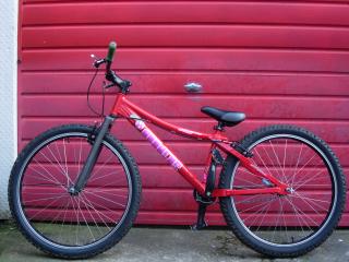

the trials mop Posted July 13, 2008 Report Share Posted July 13, 2008 I ride this for street and some park fagging Quote Link to comment Share on other sites More sharing options...
