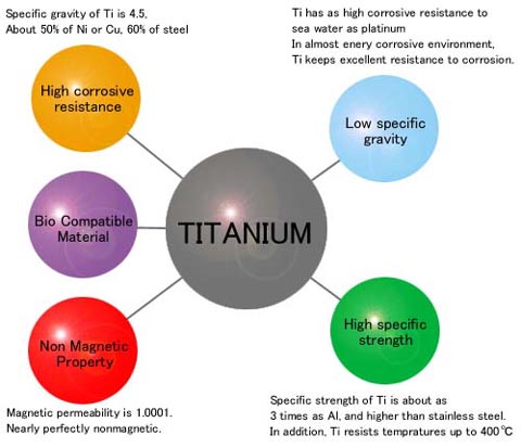

Jsy Ben Posted July 8, 2008 Report Share Posted July 8, 2008 Quote Link to comment Share on other sites More sharing options...
Tim/Trialsin USA Posted July 8, 2008 Report Share Posted July 8, 2008 It is obviously the lack of magnetic permeability and the fact it can handle 400C on those really warm summer days.......... Quote Link to comment Share on other sites More sharing options...
Jsy Ben Posted July 9, 2008 Report Share Posted July 9, 2008 Huh? sacism? meh, just thought i'd throw it in...might be usefull to someone/somewhen/somewhere Quote Link to comment Share on other sites More sharing options...
