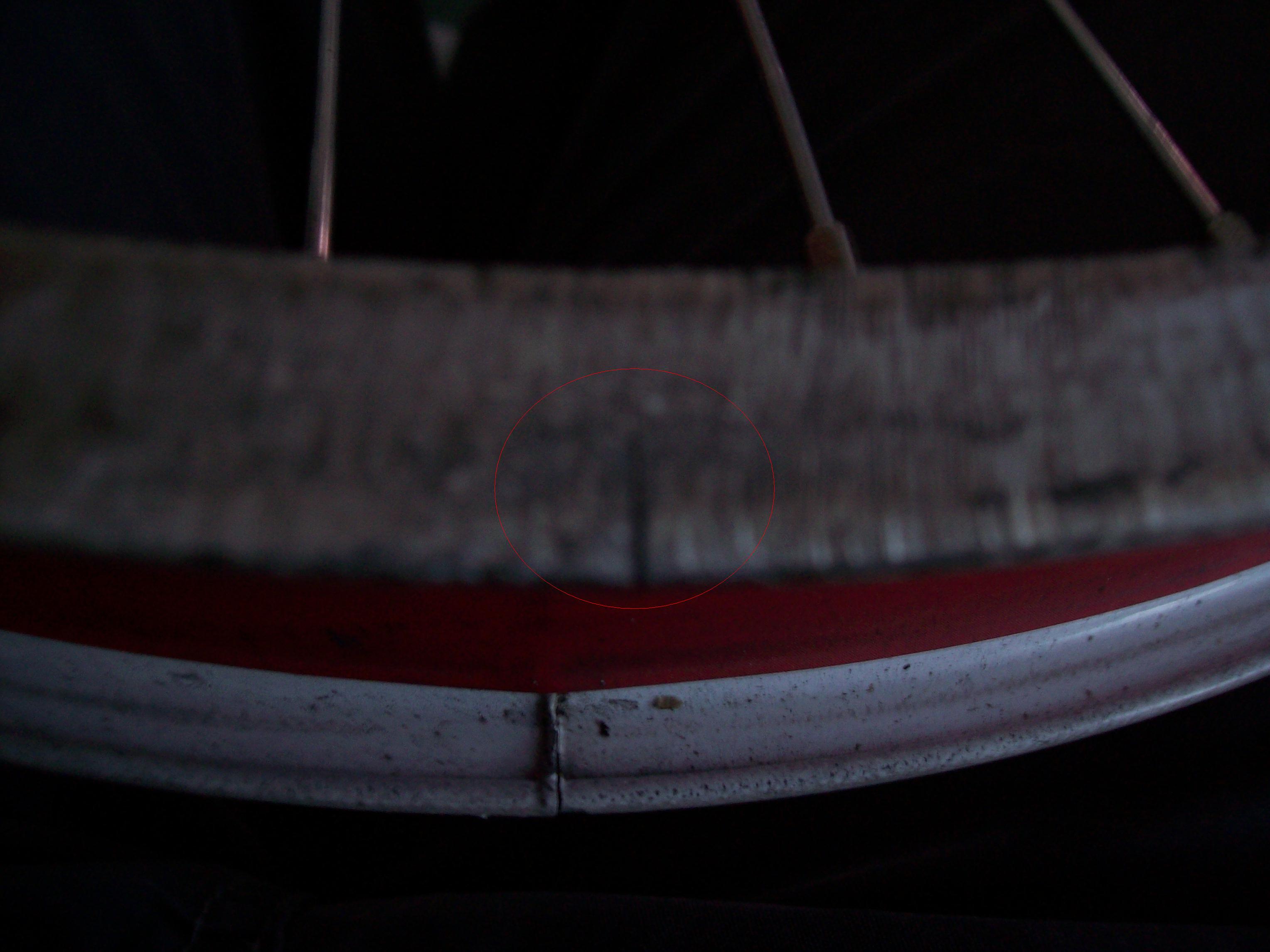

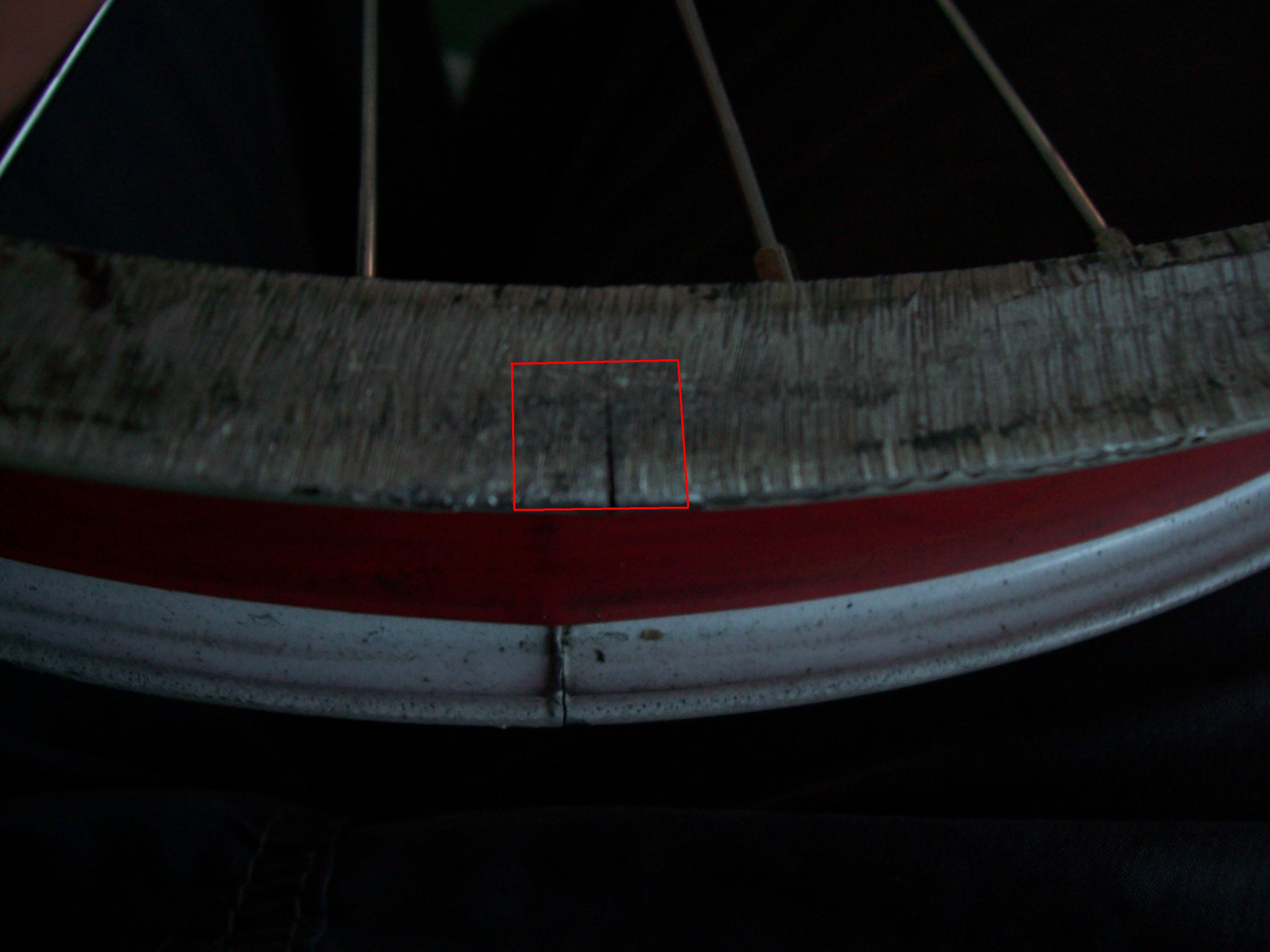

jsy trials matt Posted July 3, 2008 Report Share Posted July 3, 2008 hi guy's, right ive had this rim about 5-6 months and im not to sure if it's cracking or is this natural wear and tear. The rim has split where is joins, basically where the rim seperated has started to come apart, please give me some help on what to do. p.s It's an echo rim 2007 Thank's Guy's pic's: Quote Link to comment Share on other sites More sharing options...
Ladd Posted July 3, 2008 Report Share Posted July 3, 2008 Mine did that ! ran fine though still on my mates bike, it did get smaller when i tightend the spokes either side Quote Link to comment Share on other sites More sharing options...
Simpson Posted July 3, 2008 Report Share Posted July 3, 2008 Probably.... are you special? Either it is broken or it isn't... its 6 months old which is a good time for a rim to last and if it still spins then its all gravy... can you fit anything in between it? rims gernally seem to go on a join. Quote Link to comment Share on other sites More sharing options...

jsy trials matt Posted July 3, 2008 Author Report Share Posted July 3, 2008 Probably.... are you special? Either it is broken or it isn't... its 6 months old which is a good time for a rim to last and if it still spins then its all gravy... can you fit anything in between it? rims gernally seem to go on a join. yea but i bought an echo rim as was advised they would last a long time, my try-all one lasted me a year and a half Quote Link to comment Share on other sites More sharing options...
Tom_ Posted July 3, 2008 Report Share Posted July 3, 2008 Just ride it jeez. It hasnt split in two. Itl be fine. Quote Link to comment Share on other sites More sharing options...
Mike Winton. Posted July 3, 2008 Report Share Posted July 3, 2008 LMAO thats nothing. its only the join will last for ages yet Quote Link to comment Share on other sites More sharing options...

Dale-Hill Posted July 3, 2008 Report Share Posted July 3, 2008 Mine did that ! ran fine though still on my mates bike, it did get smaller when i tightend the spokes either side If its the 05 echo one that your on about mike, yep it'll be reet mine is same i just run harder psi now and its fine and am i basher i killed a alex dx32 Quote Link to comment Share on other sites More sharing options...
Ladd Posted July 3, 2008 Report Share Posted July 3, 2008 If its the 05 echo one that your on about mike, yep it'll be reet mine is same i just run harder psi now and its fine and am i basher i killed a alex dx32 wasnnt talkin bout your one i had a echo 07 ages ago but yeah the echo 05 did it aswell they all good Quote Link to comment Share on other sites More sharing options...
Captain Scarlet Posted July 3, 2008 Report Share Posted July 3, 2008 Try and file away some of the metal on that area, if the "crack" disapears then your problem is solved. If its still there, its either the join or a crack. Quote Link to comment Share on other sites More sharing options...
The Duck Posted July 3, 2008 Report Share Posted July 3, 2008 hi guy's, Thank's Guy's pic's: Nice use of apostrophes Don't worry about the rim, if it gets worse, as in a 2-3mm gap - replace it. Quote Link to comment Share on other sites More sharing options...
Deonn h Posted July 3, 2008 Report Share Posted July 3, 2008 LOL , after i built my rim it was like that , nothing to worry about man it will be fine jus ride ye. Quote Link to comment Share on other sites More sharing options...
Dave Anscombe Posted July 4, 2008 Report Share Posted July 4, 2008 rims do tend to spread appart on the join...but thears two 7cm rods that travvel either side of the rim join ......so that wee thing is fine.....tighten the spokes up a sniff and it will pull together. my try all rims do that alot so i just tighten the spokes a sniff -job done Dave x your rim is fine Quote Link to comment Share on other sites More sharing options...
AdamR28 Posted July 4, 2008 Report Share Posted July 4, 2008 That's just the join. Tighten the two spokes either side of the join and it will pull together (and stop bashing so much in future ) Edit: Oops, too slow... Quote Link to comment Share on other sites More sharing options...

N Roach Posted July 4, 2008 Report Share Posted July 4, 2008 You have just landed on the join of the rim. Nothing major...most rims ive seen have this. If it spins. it's fine:) Quote Link to comment Share on other sites More sharing options...
Ashley-Wood Posted July 4, 2008 Report Share Posted July 4, 2008 my echo rim is brand new and has this, all of my rims have done this lol! just ride it, and bash it if you can offord to buy a new one and to get re-spoked lol! Quote Link to comment Share on other sites More sharing options...

Simpson Posted July 5, 2008 Report Share Posted July 5, 2008 Ive had a 1 inch 5mm deep guage out my sidewall before which i snapped off and it worked for a good few months.... f**ked up my pads though, and the tyre fell off sometimes Quote Link to comment Share on other sites More sharing options...
