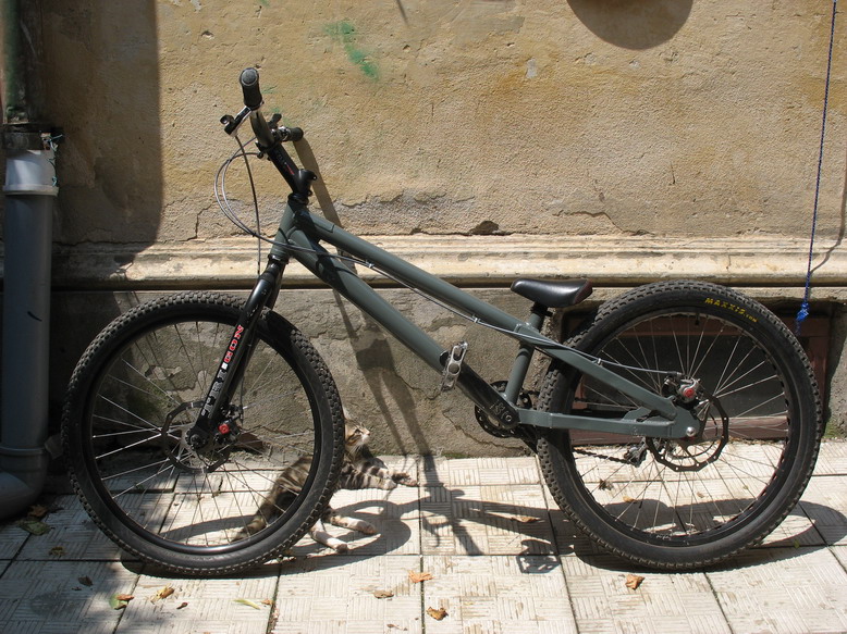

the trials mop Posted July 13, 2008 Report Share Posted July 13, 2008 what frame is that? it looks beaut Quote Link to comment Share on other sites More sharing options...
zoster Posted July 13, 2008 Author Report Share Posted July 13, 2008 what frame is that? it looks beaut it's a mielec custom (i might make a thread about the bike once i put the new brake in) Quote Link to comment Share on other sites More sharing options...
