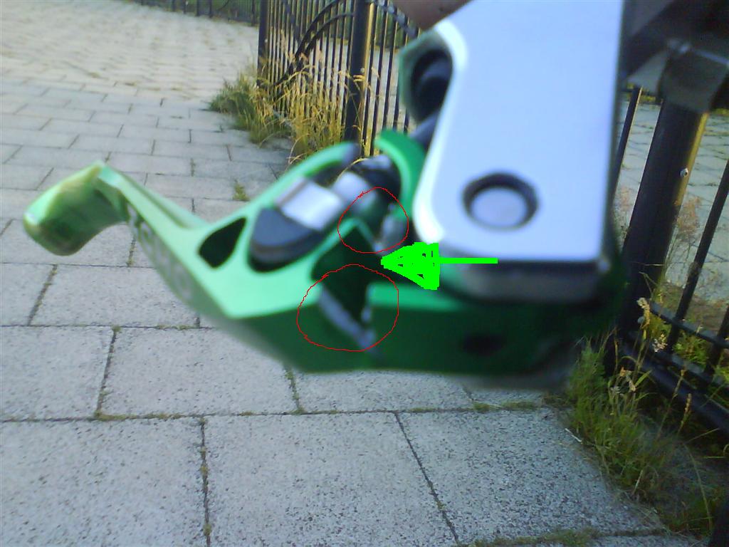

LiamWood! Posted June 25, 2008 Report Share Posted June 25, 2008 This evening on Danny Mill's Gu typhoon his dengura leaver blade developed a crack next to one of the holes with factory has added on onto the levers from the older designs. Could this have made these new style leavers weaker, or maybe just a leaver from a dodgy batch? Anybody elses snapped or cracked the new style dengura leaver blades? Pics: Liam Quote Link to comment Share on other sites More sharing options...

LiamWood! Posted June 25, 2008 Author Report Share Posted June 25, 2008 He was hooking a wall, then he noticed that it had cracked, pulled the leaver in again and watched it spread accros the whole leaver blade! Quote Link to comment Share on other sites More sharing options...

LiamWood! Posted June 25, 2008 Author Report Share Posted June 25, 2008 After Picture: Quote Link to comment Share on other sites More sharing options...

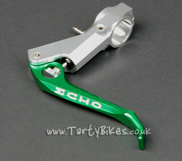

forteh Posted June 26, 2008 Report Share Posted June 26, 2008 erm no actually, these werent avaliable to the public for a long old time before they were released. anyhow, ive had mine for 7/8months and its fine still Is yours the 2008 model with the extra hole though? This is the original design which appears to be fine. This is the new design with the uber weight saving hole where the green arrow is pointing, this creates 2 massive stress raisers where the red circles are which is funnily enough where its f**ked itself In my opinion its a shit design Quote Link to comment Share on other sites More sharing options...
LiamWood! Posted June 26, 2008 Author Report Share Posted June 26, 2008 I think its a rubbish design, if they had not drilled the holes but rounded the lever end that would be spot on and this could be avoided . Quote Link to comment Share on other sites More sharing options...

spaceman Posted June 26, 2008 Report Share Posted June 26, 2008 I think its a rubbish design, if they had not drilled the holes but rounded the lever end that would be spot on and this could be avoided . I wonder what was going through Deng's mind when he designed it. I mean, so many of you can point out the faults, so surely he must have thought of it too right? Quote Link to comment Share on other sites More sharing options...
Shaun H Posted June 27, 2008 Report Share Posted June 27, 2008 Deng's an engineering graduate AFAIK. I suspect it'll be an imperfection in the material, i.e. a manufacturing fault rather than a design failure. Quote Link to comment Share on other sites More sharing options...
