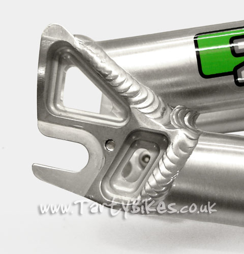

Hi guys - just wondering if anyone has heard of a 116mm pitbull or echo control running an 18/14 or 18/13 gear ratio rather than the manufacturer recommended 18/15.
I find 18/15 a bit light - wouldnt mind swaping to a horiz dropout 26" to get rid of the chain tensioner... and a bit of weight, not to mention a predictable drivechain woes!

Not strictly speaking true. On my BMX at the moment, I'm running 28:9 and unless I file my drop-outs inwards more, I'm stuck with running my back wheel with my axle pretty much hanging out the back of the dropouts. I can't get a half-link to go on there unless I file them in a bit more, it sucks. So yeah, he might have the same problem on his Zoo, and I'm assuming that if you ran the wheel right at the back of the dropouts anyway it might make brake setup a bit more tricky?
You could just give it a go though, I guess. If it's a simple case of buying a new sprocket for the back and putting it on, it shouldn't be too hard to do. I doubt I'd go as low as 18:13 though, on a stock that'd be mental.

I just wonder if i ran 18:14 would the axel be hanging out of the dropouts.

I'm riding a Adamant A1 116mm with 18-15 gearing, an my chains a little slack unless the wheels as far back as possible. Its not enough to have it forward with a link out though, so 18-14 you should be alright :)
(Adamant an the Pitbull have the same 377mm chain stays)

I know how you feel, 18/15 is too low. Feels like your going nowhere when tapping stuff. I loved 18/14, gaps weren't a problem and 170mm cranks were fine. I never actually found a disadvantage to it, apart from the chainstay length problem. I had a Control 116mm and 18/14 was fine but the chainstay length ended up being like 380mm which sucked. The wheel was right at the back of the dropouts but safe enough to run. I also tried filling my dropouts out more so the wheel could be slammed further in, didn't work though. Simply wasn't enough room unless i got rid of the snail cams which was too risky plus the resale value would end up as £0.
In the end i couldn't be arsed, and went back to mod. If you want 380mm chainstays then go for it.

The chainstays on the 116mm bikes are 377mm anyways.... do you mean theres only a 3mm difference bewteen them If i run an 18/14 ratio.
I was playing with 18/13 today... class (Y)

380 was an estimate. But i think they must be like 377 centre to centre. If 18/13 works, keep it.
