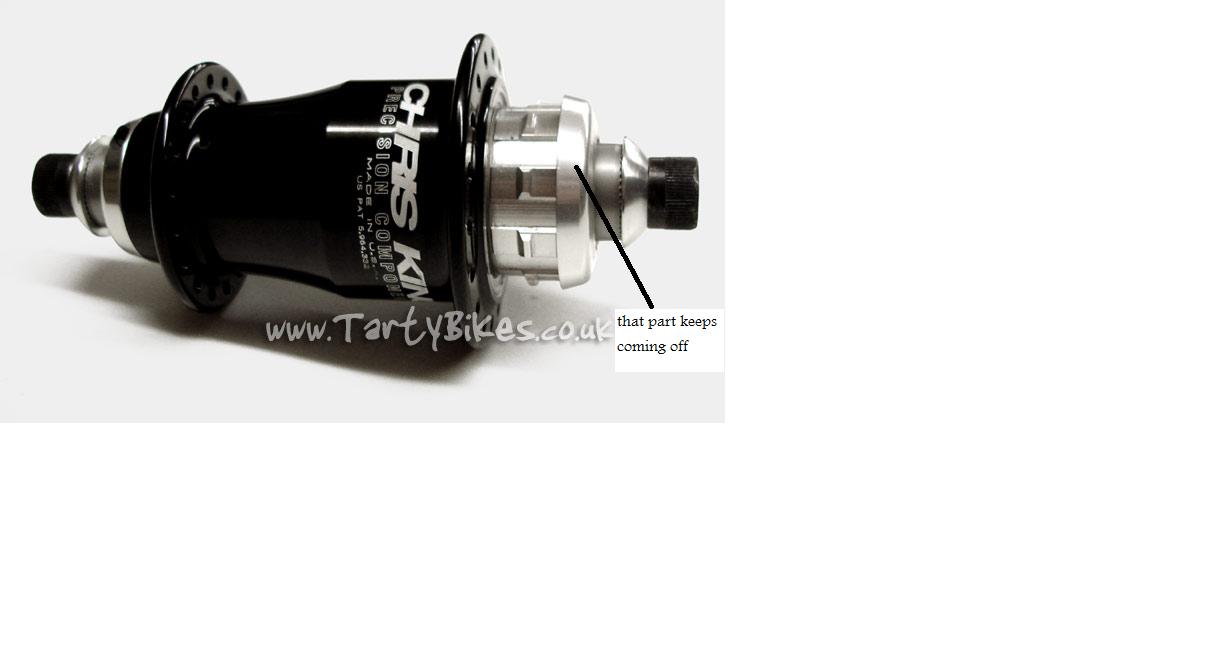

gu trials Posted May 7, 2008 Report Share Posted May 7, 2008 HI all i have had a chris king for a while now bout 6 months and since the 1st gap i did with it on my bike the lock ring has kept coming loose and then coming off no matter how tight i put it any sugestions what could be wrong because i have had a look at it and it seems ok to me. thanks if anybody can help me. Quote Link to comment Share on other sites More sharing options...
gu trials Posted May 7, 2008 Author Report Share Posted May 7, 2008 anybody same problem or no what could be wrong Quote Link to comment Share on other sites More sharing options...
spartan Posted May 7, 2008 Report Share Posted May 7, 2008 you could try a little blue locktight.Sometimes stuff does that but locktight should settle er down i would think. Quote Link to comment Share on other sites More sharing options...
Karl Butcher Posted May 7, 2008 Report Share Posted May 7, 2008 Just wack some locktight in it and it should be finei had to put some locktight on my BB cos it kept coming undone every day!! Quote Link to comment Share on other sites More sharing options...
Gilman Posted May 8, 2008 Report Share Posted May 8, 2008 Yeah use some lock tite. Just make sure that you give it 24 hours to set after applying it before the next ride, to get it to work properly. Quote Link to comment Share on other sites More sharing options...
