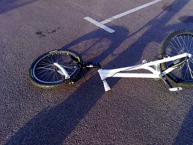

thewoomaster Posted May 2, 2008 Report Share Posted May 2, 2008 Hey dude's, well thought go on nice evening riding as the sun was out etc.. 20 mintues into riding then this happend! They were onza zoot forks that are bloodly shit lol, so any idea's on new 24inch forks i could get would be sweet Thinking about some Leeson 360's or Fundamentals, or Fattys with a disc set up. ( New forks wanted ) Quote Link to comment Share on other sites More sharing options...
Ladd Posted May 2, 2008 Report Share Posted May 2, 2008 Maggie without a booster this happens Quote Link to comment Share on other sites More sharing options...
ogre Posted May 2, 2008 Report Share Posted May 2, 2008 echo urbans, but you'd need disk. Quote Link to comment Share on other sites More sharing options...
BenLeacockā¢ Posted May 2, 2008 Report Share Posted May 2, 2008 26'' forks work fine i think ? If so the zoo forks are pritty swish ! Quote Link to comment Share on other sites More sharing options...
Mark W Posted May 2, 2008 Report Share Posted May 2, 2008 26'' forks work fine i think ? If so the zoo forks are pritty swish !If you run disc, yeah, or if you buy steel ones and have the mounts re-welded an inch lower. Quote Link to comment Share on other sites More sharing options...
ogre Posted May 2, 2008 Report Share Posted May 2, 2008 If you run disc, yeah, or if you buy steel ones and have the mounts re-welded an inch lower.doesn't that put extra stress/new stress riser on forks = faster rape? Quote Link to comment Share on other sites More sharing options...
Mark W Posted May 2, 2008 Report Share Posted May 2, 2008 Phil F's been running re-welded forks like that for a while and they've been fine. If they get re-welded well, they should be OK... Quote Link to comment Share on other sites More sharing options...

monkeyseemonkeydo Posted May 3, 2008 Report Share Posted May 3, 2008 Yeah... zoot forks do that. It's only a matter of time unfortunately. Quote Link to comment Share on other sites More sharing options...
Mike Winton. Posted May 4, 2008 Report Share Posted May 4, 2008 Mine did the same, possibly the worst forks ive ever seen. Quote Link to comment Share on other sites More sharing options...
JonMack Posted May 4, 2008 Report Share Posted May 4, 2008 Maggie without a booster this happensPlease don't let this become another trials forum bullshit story."Your forks broke above the maggie mounts, if you had a booster on it would have been fine"It's a load of shit. Quote Link to comment Share on other sites More sharing options...

Mark W Posted May 4, 2008 Report Share Posted May 4, 2008 Please don't let this become another trials forum bullshit story."Your forks broke above the maggie mounts, if you had a booster on it would have been fine"It's a load of shit.In fairness, a bunch of people cracked their frames 'cos they weren't running boosters. Every fork that I've seen break there has broken there with a Magura on. Like you don't get disc forks breaking there if you're running disc, do you? It'd either be crown junction, steerer, or the good ol' fashioned tab-crack.Forks are getting lighter, and when you start using powerful rim brakes on them they're going to flex. Every time you stress aluminium it goes towards f**king it over 'cos of the way aluminium builds up stress accumatively (or whatever the f**k the word is...) - unlike steel/ti where they have a point where they can be flexed to without it damaging it.Either way, there's logic behind it. Quote Link to comment Share on other sites More sharing options...
Muel Posted May 4, 2008 Report Share Posted May 4, 2008 If you run a front maggy without a booster, then it's pretty obvious that it is more likely to brake, but it's not set in stone. Quote Link to comment Share on other sites More sharing options...
