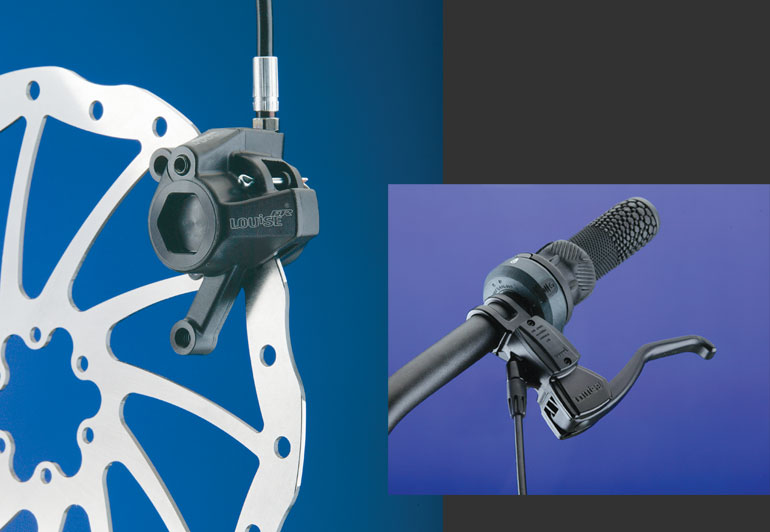

Hi i bought a magura Louise fr from ebay and it arrived this morning , it looks good and is in good condition so i fitted the rotor and put the caliper on my forks but the rotor is hiting the back of the caliper as if its to big.
it is a 180mm magura sl rotor that is supposed to go with the brake but it hits, i tried a 160mm rotor but it only comes half way up the pads so i think the caliper is defiently 180mm like it was listed as.
I've got echo control forks and I've had a 180mm mono trial which worked fine so i don't think the disk tabs welded wrong.
please help
this is what the brake looks like
How much does it hit? does it still spin?
My louise FR disc rubbed metal to metal but it's still spun. If that's the case just file a little off the outside, mine just made an annoying noise more than anything.
New forks or new disk is your option. Measure from the centre of the disk to the very edge and when you buy a new one ask it to be measure as although they should be the same 180 there will be slight differences between models and makes.
it didnt spin to well but i kind of forced it abit and its made a small grove and spins better now but i dont want to make the groove any bigger incase it goes through to the oil. do you mean file the rotor?
use a grinder and file edges to take any bures off.
