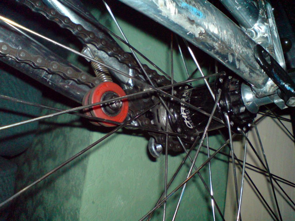

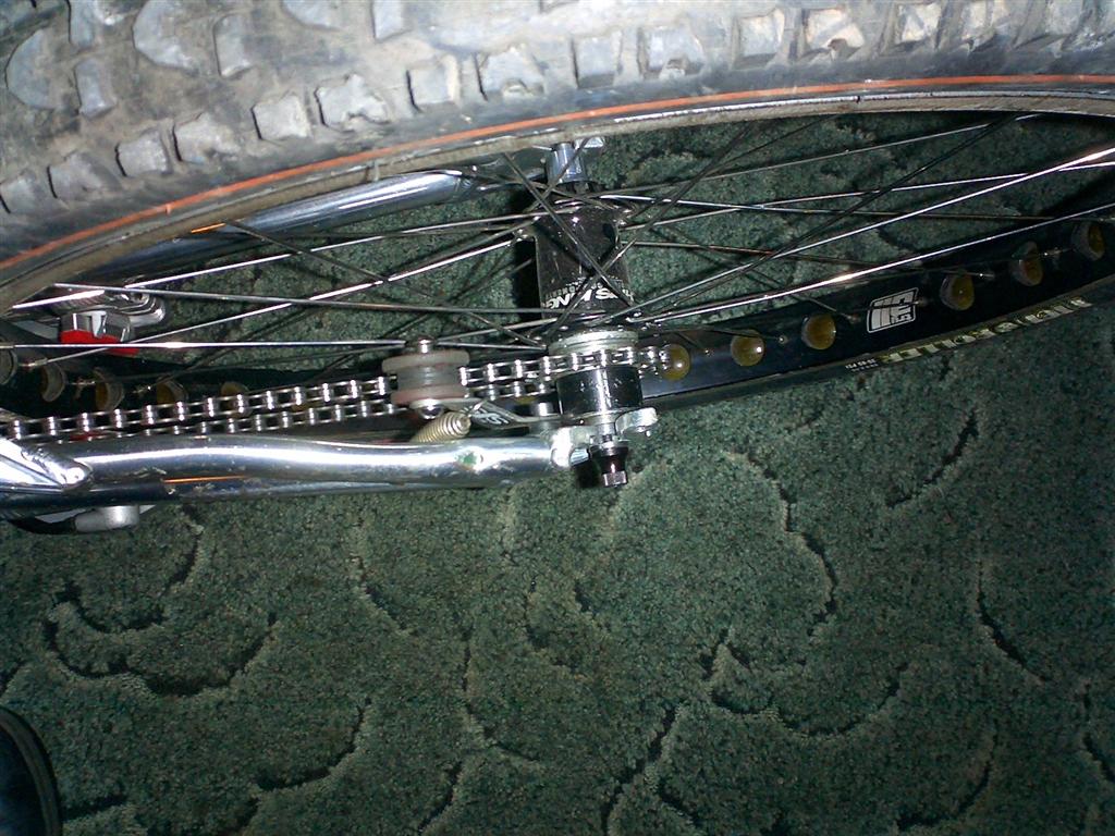

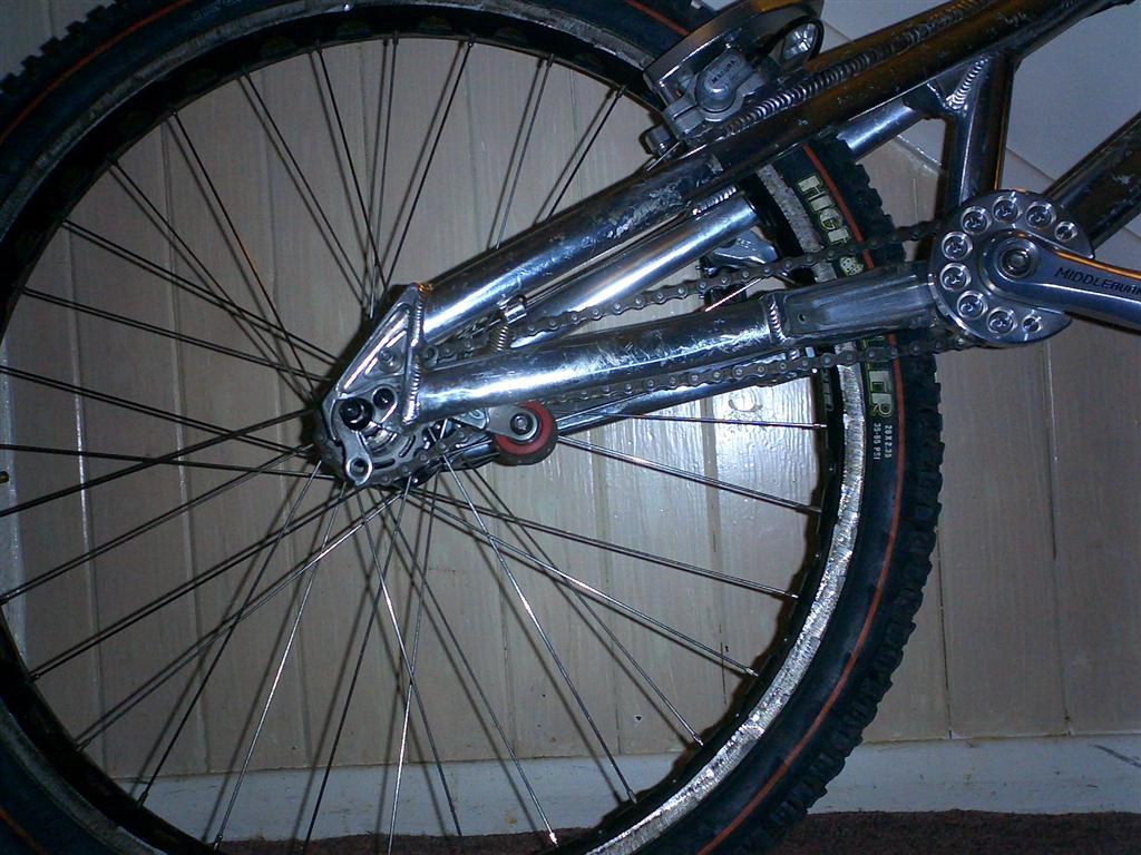

Here you go, but only because you begged :shifty:
Jobs a good'un
Bare in mine its only realyl in prototype at the moment. For the next one i think im going to bend the spoke round the chain, so that it almost hugs the chain. But for now, that is working really well, and as its tucked away, i havent yet landed on it!
Owen
It works surprisingly well to be honest! So far i havent had any problems with it, just occasionally i have to bend it down a bit more for better tension, but thats it really.
Used it on about 2-3 small rides now, and seems to be fine, and because its tucked away behind the chainstay almost, i havent yet landed on it!
Owen
