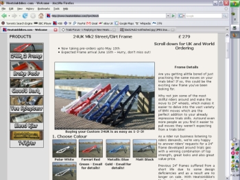

Heatsink Posted April 28, 2008 Author Report Share Posted April 28, 2008 Update: Now taking pre-orders upto May 15th Steve Quote Link to comment Share on other sites More sharing options...

Heatsink Posted May 8, 2008 Author Report Share Posted May 8, 2008 Hi!There are some tweaks that will be added in the next batch, lets call it the Mk2.5, all from rider and forum feedback: Slightly tweaked seat position to maximise ease of seat slamming without hitting the tyre. Slight raising of the seat stay - top tube join up the seat tube, to assist with (1) and also to improve looks. Integrated booster bottom edge is now revised for max tyre clearance (2.7" Maxxis tyre plus plenty of room if your wheel isn't 100% true) Under downtube gusset from BB is now decreased in length. It was rather long before! This improves looks and reduces weight. Rear Magura 4bolt spacing being reviewed. Possibly brought in from 103mm. Cable guides under top tube to be zip tie type ones. Even more cable hold when the frame is thrown around.Finally the Paypal cart is working again on my site after over a week being down, so I'm looking forward to helping hook up more riders with 24UKs up until the 15th May Pre-order cut off date.Expect detailed build guides going up on my site soon too, to help answer the many FAQs I get asked via email. Also, a photo based guide to how I got my new 24" specific forks sorted with Magura 4 bolt mounts added on the rear. I'll be building up an 24UK with these on very soon with all maguras F&R rather than the Vees F&R I've been running in recent years.Steve Quote Link to comment Share on other sites More sharing options...
Matthew62 Posted May 9, 2008 Report Share Posted May 9, 2008 Magura mounts defently need to be brought in. To be honest in my opinion 103 is almost pointless on a 24'' - sure its wide enough for those big rims, but lets have it most people are running 29/32mm rims and its too much of a push.I think bringing them in will help greatly. Also the down sizing of the gussets seems a nice idea. I'm sure very, very little strength is lost for a much nicer aesthetic.Seat stay malarky should help a great deal too.All these things should help out a great deal, hopefully won't dissapoint any mark 2 only owners. Quote Link to comment Share on other sites More sharing options...
spaceman Posted May 9, 2008 Report Share Posted May 9, 2008 Hi!There are some tweaks that will be added in the next batch, lets call it the Mk2.5, all from rider and forum feedback: Slightly tweaked seat position to maximise ease of seat slamming without hitting the tyre. Slight raising of the seat stay - top tube join up the seat tube, to assist with (1) and also to improve looks. Cable guides under top tube to be zip tie type ones. Even more cable hold when the frame is thrown around.SteveSo the new 24UK's seat tube to top tube wouldn't be in a straight line? Doesn't look quite nice to me when I imagine how it would look like.But the current cable guides seem to be a snug fit though.All these things should help out a great deal, hopefully won't dissapoint any mark 2 only owners.Haha, thankfully no. Quote Link to comment Share on other sites More sharing options...
