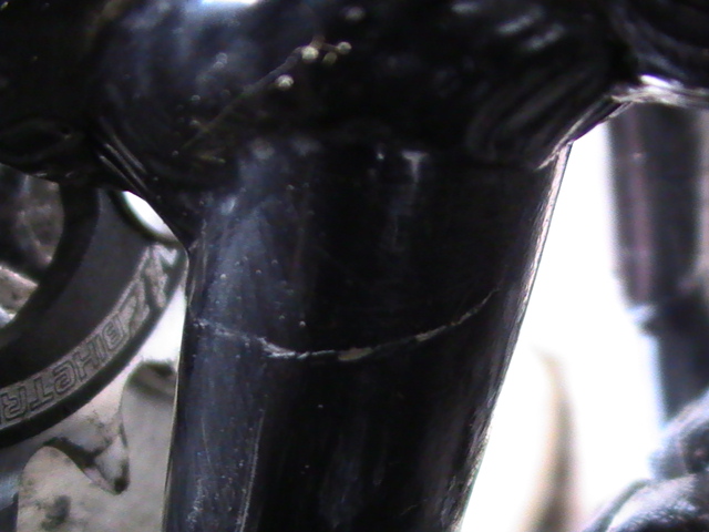

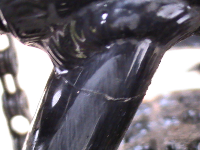

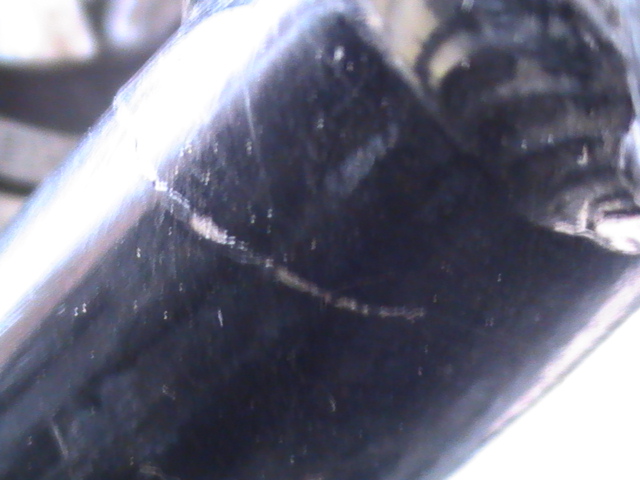

slug Posted March 15, 2008 Report Share Posted March 15, 2008 I was out riding to day and heard a horrible noise couldnt find anything so i checked the frame over and found this Is it a crack?Sorry for rubbish pics Quote Link to comment Share on other sites More sharing options...
Skoze Posted March 15, 2008 Report Share Posted March 15, 2008 (edited) I'm no expert but yes.Could just be in the paint if you're lucky. What frame is it? Edited March 15, 2008 by Skoze Quote Link to comment Share on other sites More sharing options...

Ladd Posted March 15, 2008 Report Share Posted March 15, 2008 i dont know i think my dad is going to try and weld itDont do that it will be even worse because when it is welded back the metal is britle and snaps easyer than ever you need it heat treated or leave it and get a replacement ! Quote Link to comment Share on other sites More sharing options...
Ben John-Hynes Posted March 15, 2008 Report Share Posted March 15, 2008 Dont do that it will be even worse because when it is welded back the metal is britle and snaps easyer than ever you need it heat treated or leave it and get a replacement !Yeah, don't home-weld it!Get it professionally doneOr get a replacementas he said^ Quote Link to comment Share on other sites More sharing options...
jacecottrials Posted March 15, 2008 Report Share Posted March 15, 2008 if its a diamondback then yes its a crack. Quote Link to comment Share on other sites More sharing options...

Andeee Posted March 15, 2008 Report Share Posted March 15, 2008 i dont know i think my dad is going to try and weld itI suggest you dont weld it. Depending on how old the bike/frame is. If you weld it your de-fecting your years manufacturers warranty. Send it back with your invoice/receipt. Im sure the shop/company will sort you out. Quote Link to comment Share on other sites More sharing options...
dan_addison Posted March 15, 2008 Report Share Posted March 15, 2008 Dont do that it will be even worse because when it is welded back the metal is britle and snaps easyer than ever you need it heat treated or leave it and get a replacement !Not exactly true. If a weld is done propaly it'll be stronger than it was in the first place. The opptimum word being "done propley" Quote Link to comment Share on other sites More sharing options...
slug Posted March 15, 2008 Author Report Share Posted March 15, 2008 I suggest you dont weld it. Depending on how old the bike/frame is. If you weld it your de-fecting your years manufacturers warranty. Send it back with your invoice/receipt. Im sure the shop/company will sort you out.Ok cheers Ben Quote Link to comment Share on other sites More sharing options...
Ben Cox Posted March 16, 2008 Report Share Posted March 16, 2008 Not exactly true. If a weld is done propaly it'll be stronger than it was in the first place. The opptimum word being "done propley"even if its done "propaly/propley/properly" the actuall weld will be strong as houses, but the molecular structure of the surrounding material will be altered making it prone to fatigue and eventually failure.Ben Quote Link to comment Share on other sites More sharing options...

Tomm Posted March 16, 2008 Report Share Posted March 16, 2008 My understanding is that welding aluminium is only really a good idea if you strip the frame completely, weld it and then heat treat the whole frame. All of this costs a lot and it'll still be weaker, so it just doesn't make sense at all.Send it back with your invoice/receipt. Im sure the shop/company will sort you out.I'm sure they won't...Just suck it up and save for a new frame. Quote Link to comment Share on other sites More sharing options...

RossMcd Posted March 16, 2008 Report Share Posted March 16, 2008 (edited) think you are in the same boat as me mate mine didnt make a noise as you described it to have make but i noticed mine as my wheel was rubbing off the frame!your one has gone in the exact same place too!How long have you had yours?I wasnt that harsh on mine eather but i think it may have been the magura that caused it as i noticed it flexed so much more when it was snapped here is a better pic of mine I took todayOh and dont bother trying to get a hold of diamondback because it didnt help me one bit. Edited March 16, 2008 by RossMcd Quote Link to comment Share on other sites More sharing options...
