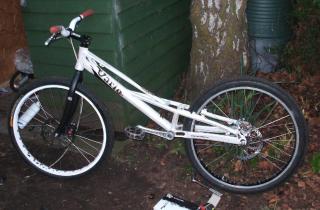

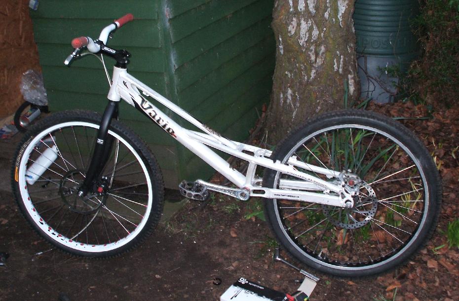

Frame arrived today from 'Boss', I've always wanted one so i thought I might as well take the oportunity when his came up for sale!
I know opinions are going to be mixed, but I really like them.
It's a short by the way.

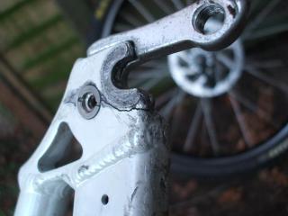

Only gay thing is the right hand dropout is majorly cracked and he didn't tell me :angry: but I'll get it welded before I ride!

I don't know why he didn't tell me, but I'll try to get it welded and I only think it's fair he pays for it!
It won't be ready to ride Ipswich this weekend :( Got to find someone who can weld aluminium, I think N&A engineering might do it, if not I'll ask my friend.

You can hardly miss it as when you unbuilt the bike you must of seen it when you undid the wheel bolts, and no way that could of been done in transit. To crack it there would be super hard, even if you could hold the frame at that point with mole grips and lift the bike up it wunt crack i doubt with all the weight and such a big lervage. Even if you cracked it with a hammer pritty hard it still would take a hefty wack to crack. Well really the cost of repair should be a fair lot, as the frame needs welding and heat treating and that isnt cheap. If it isnt heat treated then the frame is weaker around that area due to the heat from welding and will proberly crack after quite awhile as alot of stress go through the frame there from gaps and drops ect

My point is though that he says he will compensate him but it wont be cheap due to a weld will do nothing but weaken the metal and make it last that bit longer.
