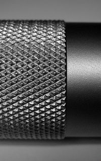

SCOTTY___ Posted February 10, 2008 Report Share Posted February 10, 2008 (edited) They put a knurl of the side of the rim.. if im thinking correctly. like show below Edited February 10, 2008 by Echo_Scotty Quote Link to comment Share on other sites More sharing options...
Mike Winton. Posted February 10, 2008 Report Share Posted February 10, 2008 They put a knurl of the side of the rim.. if im thinking correctly. like show belowThats it, couldnt think of the word No idea where you would find somewhere witha machine to do it on a rim leek. Quote Link to comment Share on other sites More sharing options...

Revolver Posted February 10, 2008 Report Share Posted February 10, 2008 it would be interesting, but, loads of people like ground rims, so maybe manufacturers should make rims knurled?I think knurling your rims would be better than grinds, but if you were to do it, the pressure needed to make the knurl work could possibly collapse the walls. After all, rims aren't really made to withstand being squashed from the side like that, its a force that is pretty much non-existent on a bike Quote Link to comment Share on other sites More sharing options...

Mike Poyzer @ Onza Posted February 11, 2008 Report Share Posted February 11, 2008 We made samples and tested them about 4 years ago. Abandoned it on the grounds of cost. A very expensive process. Quote Link to comment Share on other sites More sharing options...

Walleee Posted February 11, 2008 Report Share Posted February 11, 2008 It was CNC machined on the DX32 that your talking about. I started or at leats posted in a topic about it when I first joined here, some arsehole said it was knurled, he clearly hadn't read the original thread on OTN. but yeh, not really a cost effective option.... Quote Link to comment Share on other sites More sharing options...
cai Posted February 11, 2008 Report Share Posted February 11, 2008 Didnt onza do something like that but stopped?Onza did them on Reggie and Ronnie rims a while back. Quote Link to comment Share on other sites More sharing options...
SCOTTY___ Posted February 11, 2008 Report Share Posted February 11, 2008 Onza did them on Reggie and Ronnie rims a while back.That isnt a knurling process, looks like something of an old milling finish ;p the worst finish on a S.F guage for milling Quote Link to comment Share on other sites More sharing options...
SCOTTY___ Posted February 11, 2008 Report Share Posted February 11, 2008 Looks good.I thought the idea behind the grind was to create 'sharp' edges on the surface to bite into the pad materials. Surely a surface like that would require a softer pad to mould to the shape, I can't imagine it being very 'sharp'. It also looks very deep, wouldn't thicker sidewalls be needed to hold the strength?trust me, its a rough as a bears arse after a phat shit Quote Link to comment Share on other sites More sharing options...
Mike Poyzer @ Onza Posted February 12, 2008 Report Share Posted February 12, 2008 That was a photograph of the sample. Worked very effectively. You can only do this process by such CNC machining. The most effective format and profiles would need a lot of trial and error. You cannot Knurl a rim surface. Knurling is effectively an embossing process and requires back support for the surface being knurled other than on a totally solid profile. The only possible way to knurl would be onto the flat sheet before the rim is profiled and as only steel rims are produced in this way and most rim profiles these days are extruded alloy, that also doesn't work. Quote Link to comment Share on other sites More sharing options...
