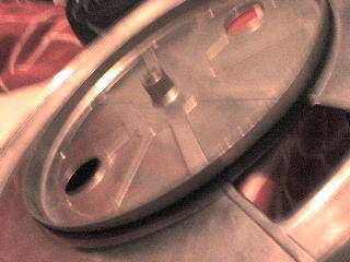

Caleb Posted January 31, 2008 Report Share Posted January 31, 2008 ive acquired a Technics SL-BD22 turntable and i need to fit the belt, i assume it mounts under the motor and onto the middle bit, ive opened her all up bit a bit unsure of specifics, anyone shed any light?diagrams would be brilliant Quote Link to comment Share on other sites More sharing options...

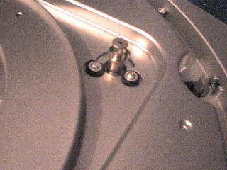

BenLeacock™ Posted January 31, 2008 Report Share Posted January 31, 2008 (edited) Will go get a pic now might help you!edit: Right mate, what you need to do is take the bit that the vinyl sits on take it off. Underneath there will be a big circle. Looks like this. (as you can see the band is still on there)Put the band around it, then there is little holes in the bit the vinyl sits on. If you carry on going round you will come across something that looks like this. stretch the band around there keeping it around the larger circle. Sorry about lack of techniqual terms (the bit the vinyl sits on ) hope it helps dude Edited January 31, 2008 by BenLeacock Quote Link to comment Share on other sites More sharing options...
MadManMike Posted January 31, 2008 Report Share Posted January 31, 2008 (the bit the vinyl sits on )That'd be the Platter And yeah, follow his instructions...Some turntables have 2 places to put the belt so you can play at different speeds - most modern ones have a speed button on top though so you're probably alright there Quote Link to comment Share on other sites More sharing options...

Caleb Posted January 31, 2008 Author Report Share Posted January 31, 2008 hahahaha thanks a lot man, seriously had every scre out diverting the belt through holes and gaps, all sorted now think i just need a pre amp and speakers and im away. Quote Link to comment Share on other sites More sharing options...
