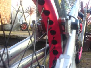

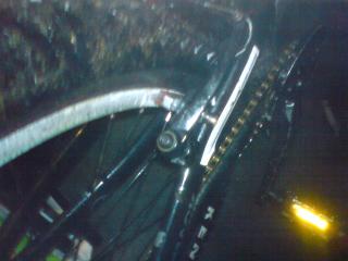

Could you pop up some photos of your set-up? Maybe some local riders can give their 2nd opinion?

I really dont want to sound like a moaner here but mine are so crap, all of the norwich riders will back me up on this as well.
Heres a picture of the setup.
The only thing i can think of is that i didnt use any glue when i put them in the backings :blink: will that make any difference?
They really have no hold or bite and ive had them for about 3 weeks now and even tryed a fresh medium grind but no joy :(
Would the best bet be to glue the pad to the backings then try again?
Thanks and sorry to steel your thread abit.

here are some pics for the people! I used the macro mode on my phone so it shound be semi desent

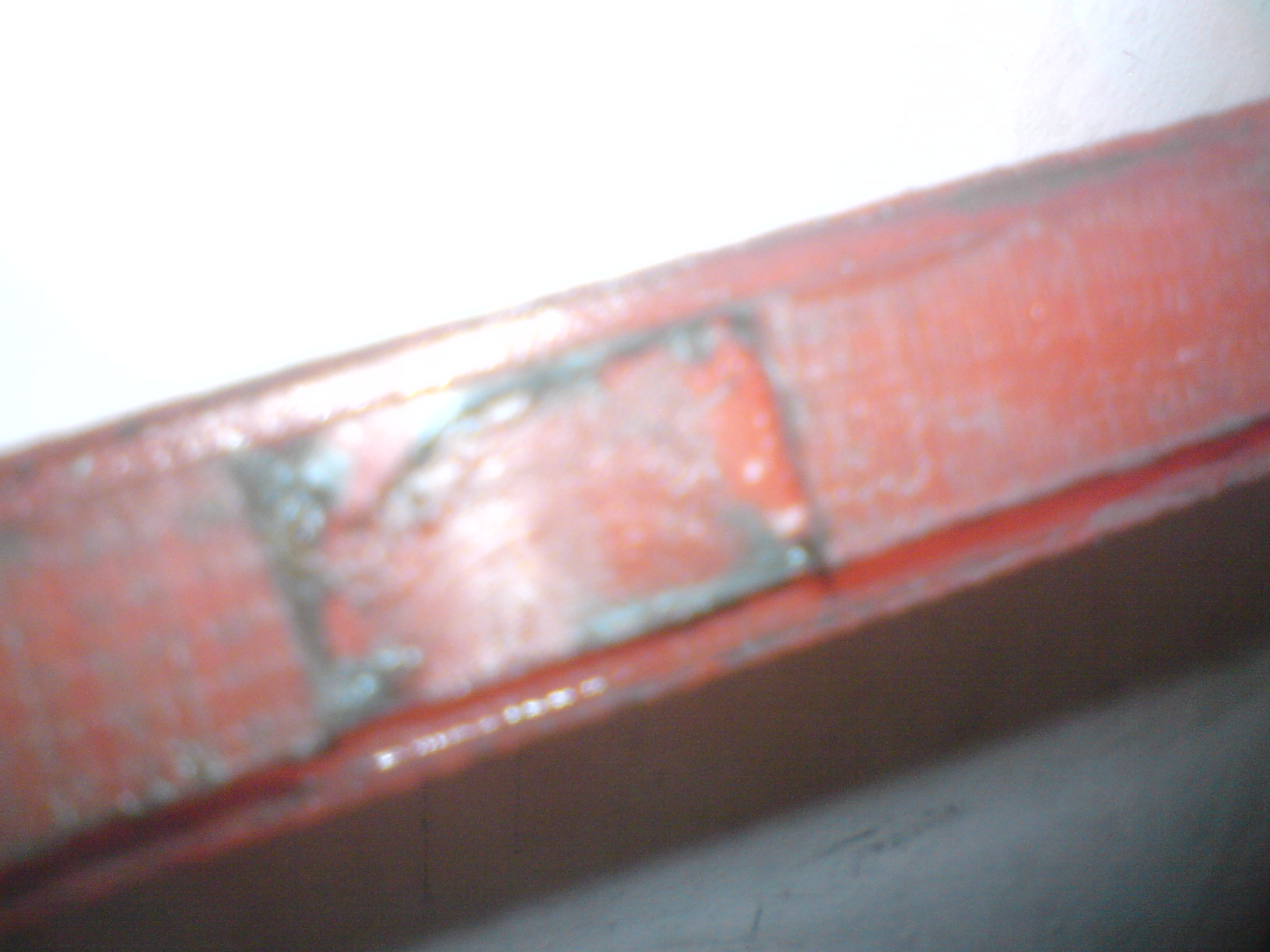

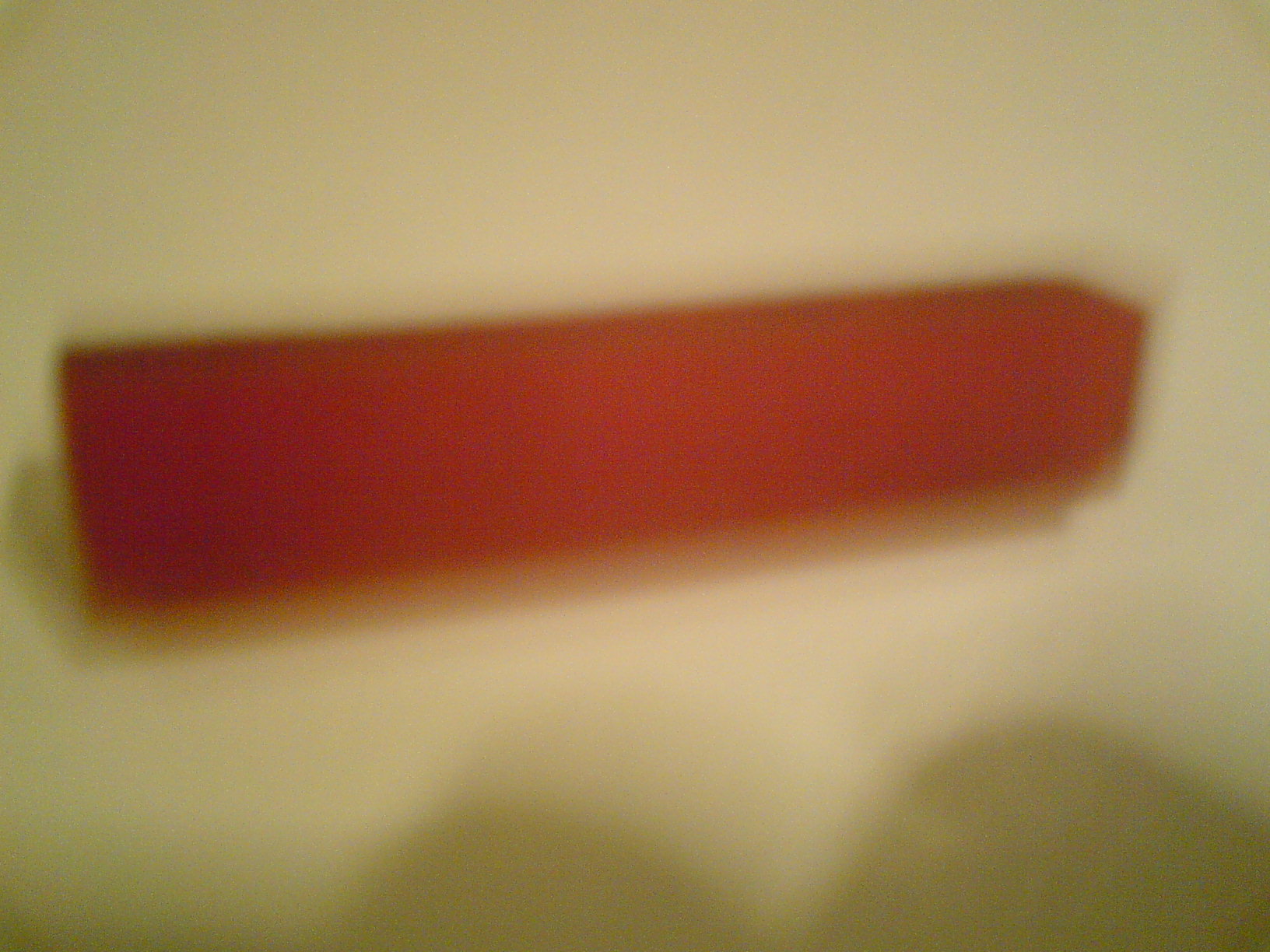

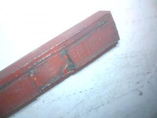

Any photos of the braking surface? The inside looks to have got some black greasy gunk in there. Are the braking faces similar? How grippy do they feel? I've got a varnished table next to my PC here where I package up pads. The reds are very stubborn about not wanting to slide along this with only light vertical pressure. If you're not getting a similar sort of grip, and the surface is looking contaminated with gunk, then we're starting to work out what's happening (Y)
Hi Ryan,
Could you check out the brake pad surface in a similar way? If you have a smooth and flat surface like the side of an kitchen appliance, are the pads gripping? What does the braking surface look like? The pads go out degreased and very grippy, but of course it's possible for any pads to get covered in greasy grime. I wonder where it all comes from!
If the pad braking surface has been contaminated, then give it a go with a brio pad and a house hold cleaner followed by washing off any residue with water and kitchen roll. The rims would be needing a clean too.

the surface on my pads are clean but the pad slides across my table and i can feel it is wanting to take a grip but isnt lol
EDIT: pic of brake surface, sorry about quality
Any chance of a better photo? You're welcome to pop them back in the post to me if you're feeling you've run out of energy getting to the bottom of it (Y) I can inspect, reglue, basically revitalise the pads, although if it's something about the set-up then whatever pads you use won't perform to your full expectations. Keep going, we'll get there!
