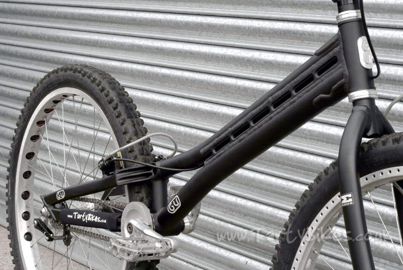

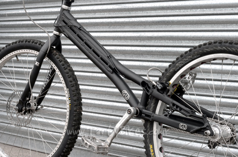

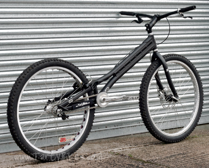

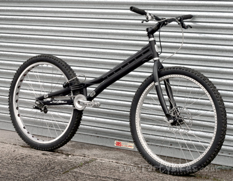

AdamR28 Posted January 4, 2008 Report Share Posted January 4, 2008 Just built one of these up for a local guy, rides really well - stiff, responsive.Geo is 1085 wheelbase, +45mm BB, 380mm stays, 72 head angle, 670mm reach (all within 5mm/0.5 degrees of Stan's Ozonys)Hope you like Ads Quote Link to comment Share on other sites More sharing options...
abtrials Posted January 4, 2008 Report Share Posted January 4, 2008 looks good apart from that massive bash on there, get a heatsink one Quote Link to comment Share on other sites More sharing options...
El Cristoff Posted January 4, 2008 Report Share Posted January 4, 2008 I thought that model was disk only? Quote Link to comment Share on other sites More sharing options...
AdamR28 Posted January 4, 2008 Author Report Share Posted January 4, 2008 20" - yes. 26" - Disc and 4-Bolt Quote Link to comment Share on other sites More sharing options...
Adam-Griffin Posted January 4, 2008 Report Share Posted January 4, 2008 20" - yes. 26" - Disc and 4-Bolt Deng must really hate mod rider's Look's ok, not keen on the bash though......... Quote Link to comment Share on other sites More sharing options...
AdamR28 Posted January 4, 2008 Author Report Share Posted January 4, 2008 Haha, no it's not that, the 20" was initially to be 4-Bolt also but he decided the frame looked too cluttered and left the mounts off for production. The TP has 4-Bolt mounts anyway, and is pretty similar. Quote Link to comment Share on other sites More sharing options...
BenLeacockâ„¢ Posted January 4, 2008 Report Share Posted January 4, 2008 Does look nice, i really like that bash Quote Link to comment Share on other sites More sharing options...
Ash-Kennard Posted January 4, 2008 Report Share Posted January 4, 2008 loose the massive bash and that is one sexy bicycle Quote Link to comment Share on other sites More sharing options...
Rusevelt Posted January 4, 2008 Report Share Posted January 4, 2008 loose the massive bash and that is one sexy bicycleYeah i absolutely agree with those comments about the bike and bashring. run a smaller bashring or black coloured one. Quote Link to comment Share on other sites More sharing options...
Andeee Posted January 4, 2008 Report Share Posted January 4, 2008 Looks sweet as! I wouldnt change the bash everyones just been a fashion rider over the size of a bash ring even though the heatsink ones are like a tidge smaller. Quote Link to comment Share on other sites More sharing options...
Ladd Posted January 4, 2008 Report Share Posted January 4, 2008 Looks mint ! Really like it apart from bash Quote Link to comment Share on other sites More sharing options...
aener Posted January 4, 2008 Report Share Posted January 4, 2008 (edited) Rather nice, but a bit plain...Didn't fancy a new rear tyre, too? Sidewalls look pretty fecked.Also - add me to MSN please, need some info about that email you sent me.I know you're off work - but I'm at work whenever you are, so I can't help that EDIT: flipp@flowflys.co.uk Edited January 4, 2008 by Flipp Quote Link to comment Share on other sites More sharing options...
tom jersey Posted January 4, 2008 Report Share Posted January 4, 2008 Very nice but if it was me the bash would be black and the cranks. Quote Link to comment Share on other sites More sharing options...
