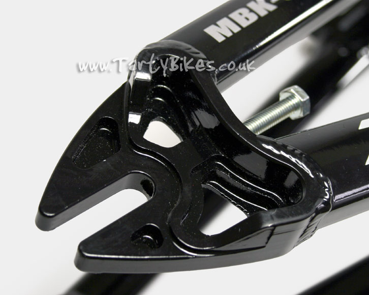

JT! Posted December 24, 2007 Report Share Posted December 24, 2007 Mike Poyzer @ Onza said: Those drop outs will be on all Mod frames from T-Mag up, and even lower down the range for 2008/2009 modelsWhat dropouts?I have used snail cams and they've been perfectly really. Can't see how there can be a better tugging system. Quote Link to comment Share on other sites More sharing options...
grantham Posted December 24, 2007 Report Share Posted December 24, 2007 JT! said: What dropouts?I have used snail cams and they've been perfectly really. Can't see how there can be a better tugging system.it's more like a pushing system than a tugging one hehe like on the new mbk Quote Link to comment Share on other sites More sharing options...
JonMack Posted December 24, 2007 Report Share Posted December 24, 2007 (edited) JT! said: What dropouts?I have used snail cams and they've been perfectly really. Can't see how there can be a better tugging system.See the threaded hole in the back of the dropout? You screw the bolt into the dropout and it pushes the wheel back. Allows much better control than snail cams do, and means your tension is always set the same even when you take your wheel out, and doesnt wear down like the notches on snail cams do.Much like this Edited December 24, 2007 by JonMack Quote Link to comment Share on other sites More sharing options...
Waynio Posted December 24, 2007 Report Share Posted December 24, 2007 there seems to be a bit too much tugging and pulling going on for my liking Wayne.they are an extremly useful design, pushing the wheel back is better than a tug, as you do seem to sometimes get problems with cams loosing a bit. Quote Link to comment Share on other sites More sharing options...
JonMack Posted December 24, 2007 Report Share Posted December 24, 2007 Waynio said: there seems to be a bit too much tugging and pulling going on for my liking Wayne.they are an extremly useful design, pushing the wheel back is better than a tug, as you do seem to sometimes get problems with cams loosing a bit.Hahah classic.Yeah I definitely think it's a much better design than tugs or cams, they're a brilliant design. Quote Link to comment Share on other sites More sharing options...
JT! Posted December 24, 2007 Report Share Posted December 24, 2007 Threads in the frame? Quote Link to comment Share on other sites More sharing options...
Tomm Posted December 24, 2007 Report Share Posted December 24, 2007 JT! said: Threads in the frame? Haha yeah, I was thinking that, although there is a LOT of thread - over an inch by the looks of it, so perhaps unlikely to go? Still, even if the thread does go, it would be easy to fix with a nut on one side so I wouldn't worry too much. Quote Link to comment Share on other sites More sharing options...

JonMack Posted December 24, 2007 Report Share Posted December 24, 2007 JT! said: Threads in the frame? Brake mounts? Quote Link to comment Share on other sites More sharing options...
Token Posted December 25, 2007 Report Share Posted December 25, 2007 JT! said: Threads in the frame? It'll be fine, most chain tugs tend to use a bolt to adjust the tension an bolts are like 4mm long of thread? Quote Link to comment Share on other sites More sharing options...
JT! Posted January 6, 2008 Report Share Posted January 6, 2008 (edited) Tomm said: Haha yeah, I was thinking that, although there is a LOT of thread - over an inch by the looks of it, so perhaps unlikely to go? Still, even if the thread does go, it would be easy to fix with a nut on one side so I wouldn't worry too much.Might be ok. I can't see why onza don't use cams to be honest. Mine are excellent. JonMack said: Brake mounts?I always strip them. Scopse said: It'll be fine, most chain tugs tend to use a bolt to adjust the tension an bolts are like 4mm long of thread?The bolts on chain tuggs are much stonger than threds on frames. Edited January 6, 2008 by JT! Quote Link to comment Share on other sites More sharing options...
