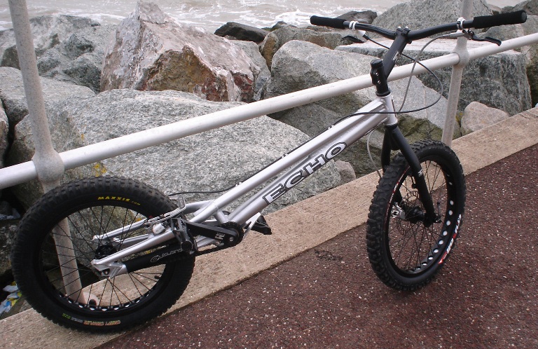

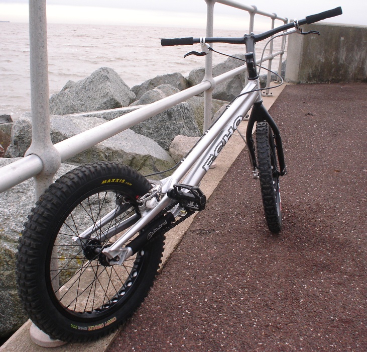

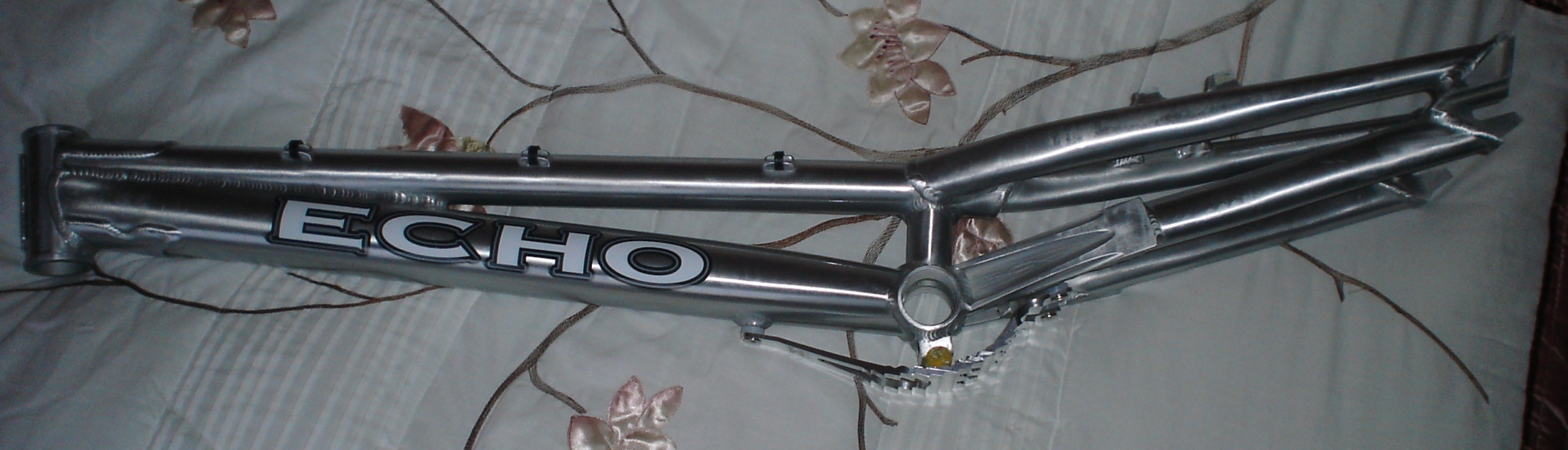

Captain Scarlet Posted November 24, 2007 Report Share Posted November 24, 2007 Many thanks to Chris (Zhi) for getting this frame for me, here it is.All good apart from a slight movement in the headset that needs sorting.Comments? Quote Link to comment Share on other sites More sharing options...

Nick Dale Posted November 24, 2007 Report Share Posted November 24, 2007 Jesus, cut the forks down tom!!! Then it shall look nice.All you gotta do now is learn to ride it Quote Link to comment Share on other sites More sharing options...

Bionic Balls Posted November 25, 2007 Report Share Posted November 25, 2007 corr....well done thutley! looks mint...you probably need to cut the steerer a bit...then you'll get more compression in the headset and stop the looseness adam Quote Link to comment Share on other sites More sharing options...

Captain Scarlet Posted November 25, 2007 Author Report Share Posted November 25, 2007 Thanks for the comments everyone.I have solved the problem with the headset, the steerer tube was about a few millimetres too big, so the top cap hit the top of the steerer before it was anywhere near tight, so it wouldn't clamp down on the spacers properly.Just a bit of filing and jobs a good'un.I'm not going to cut the steerer tube down just yet, as there is currently only about 20mm poking out of the stem, and some of this may be taken up if I change my headset.But if it becomes a problem then I will do. Quote Link to comment Share on other sites More sharing options...
Takeda Posted November 25, 2007 Report Share Posted November 25, 2007 Very nice bike!Is it long frame or short one? Quote Link to comment Share on other sites More sharing options...
Bionic Balls Posted November 26, 2007 Report Share Posted November 26, 2007 Thanks for the comments everyone.I have solved the problem with the headset, the steerer tube was about a few millimetres too big, so the top cap hit the top of the steerer before it was anywhere near tight, so it wouldn't clamp down on the spacers properly.Just a bit of filing and jobs a good'un.what exactly did you file? not the top cap surely could've just put another spacer on/cut the steerer..... Quote Link to comment Share on other sites More sharing options...

Guest Posted November 26, 2007 Report Share Posted November 26, 2007 what exactly did you file? not the top cap surely could've just put another spacer on/cut the steerer.....From what he's said i'd imagine he's filled the steerer just a little.There is no need to cut it anymore unless you feel that it's hindering your progress, I actually wish I had a bit more length on my steerer and a few spacers in there instead. Quote Link to comment Share on other sites More sharing options...

Captain Scarlet Posted November 27, 2007 Author Report Share Posted November 27, 2007 Thanks for the comments again.Its a long frame and am loving it.Its a lot easier to gap to front wheel due to the length and height of the bike, it naturally endo's you over the front.[borat]Great success!!![/borat] Quote Link to comment Share on other sites More sharing options...
