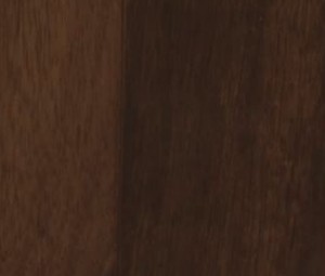

BenLeacock™ Posted November 16, 2007 Report Share Posted November 16, 2007 Hey guys need abit of a hand please Basically im making my final peice and im stuck. Need help to try and work out what wood to use as legs. Im looking for hard woods with a dark grain. The project im making is a coffee table. The rest of the table will be made out of American Walnut, i was wanting to make the legs out of this aswell but then found out i can't buy them in 4''x4'' Any sugestions would be lovely Thanks for your time Ben I also attached a picture of american walnut to save your time if you havent heard of it Quote Link to comment Share on other sites More sharing options...
