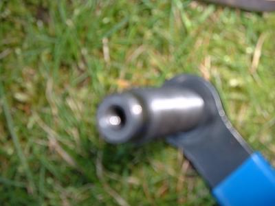

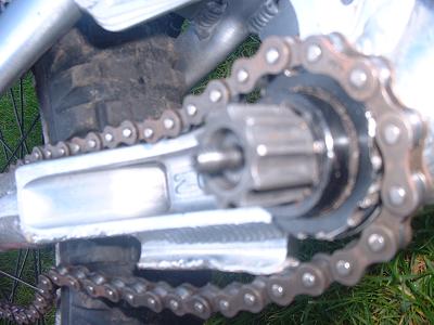

Ryan Blackwell Posted October 13, 2007 Report Share Posted October 13, 2007 Hi people got a bit of a problem. the bit from the inside of my park tool crank extractor has threaded its self into bb crank bolt threds.Is there any way of getting this out off my bottom bracket.Sorry for sh*t pics. Quote Link to comment Share on other sites More sharing options...
James Quigley Posted October 13, 2007 Report Share Posted October 13, 2007 those park tool crank pullers aren't supposed to be used on isis bb's as the bb's have a larger diameter hole, that'll be why it's stuck in there.I use an adapter that came with my bb, but people often use 5p coins.Best bet is get some mole grips and start pulling/turning it out and see if the threads are still okay. Quote Link to comment Share on other sites More sharing options...
basher Posted October 13, 2007 Report Share Posted October 13, 2007 Try tapping it with a hammer slightly trying to wiggle it free. Quote Link to comment Share on other sites More sharing options...
Bionic Balls Posted October 13, 2007 Report Share Posted October 13, 2007 oooops! Quote Link to comment Share on other sites More sharing options...
King C Posted October 13, 2007 Report Share Posted October 13, 2007 Take the crank bolt out of the other side, put something long and thin in there like screw driver a twat like you've never twatted before Quote Link to comment Share on other sites More sharing options...
Ryan Blackwell Posted October 13, 2007 Author Report Share Posted October 13, 2007 Take the crank bolt out of the other side, put something long and thin in there like screw driver a twat like you've never twatted beforeSounds like a plan BUT id like to keep the threds in my bottom bracket! Cheers though mate lol. Quote Link to comment Share on other sites More sharing options...
basher Posted October 13, 2007 Report Share Posted October 13, 2007 Sounds like a plan BUT id like to keep the threds in my bottom bracket! Cheers though mate lol.that the best way thats been sugested, and should keep your threads fine. Quote Link to comment Share on other sites More sharing options...
Matthew_Gibson Posted October 13, 2007 Report Share Posted October 13, 2007 Get two bolts the same thread size, thread one on, about 5-6mm, the thread the second one down so it hits the first one, them tighten the two together. should work if you can find a bolt the same thread.....Or mole grips???Get two bolts the same thread size, thread one on, about 5-6mm, the thread the second one down so it hits the first one, them tighten the two together. should work if you can find a bolt the same thread.....Or mole grips??? Quote Link to comment Share on other sites More sharing options...
br3n Posted October 13, 2007 Report Share Posted October 13, 2007 (edited) Get two bolts the same thread size, thread one on, about 5-6mm, the thread the second one down so it hits the first one, them tighten the two together. should work if you can find a bolt the same thread.....do that, no damage to your threads or tool..(counter-turning) Edited October 13, 2007 by br3n Quote Link to comment Share on other sites More sharing options...
