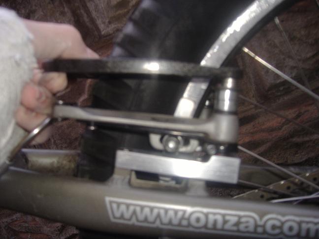

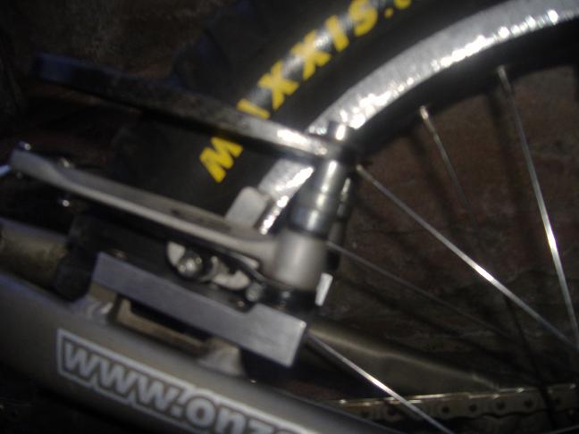

aener Posted October 10, 2007 Report Share Posted October 10, 2007 So I've got a Vee, with SD7 arms, on my T-Pro.Running a Hog rim, with a Crawler.Adaptors are handmade by Ed Potts (dave85), but are rather similar in geo to the Heatsink efforts.WAS running a Shimano XTR Carbon booster, but it doesn't fit anymore... Got a new chain, had to get new adaptors ad yada yada yada...It's too short, and the tyre just rubs it enough to start a fire Anyone fancy being a superGod-type thing, and letting me know what might be of adequate size?Did a search, to no avail.Thanks in advance (Haha, rhyme)-Flipp Quote Link to comment Share on other sites More sharing options...

Zordon Posted October 10, 2007 Report Share Posted October 10, 2007 Depending on the seatstays geometry (works with my GU 07, didn't work with Monty 221Pr) adding some spacers under adaptors and/or booster (often together with getting longer bolts) will make a better tyre clearance. Quote Link to comment Share on other sites More sharing options...

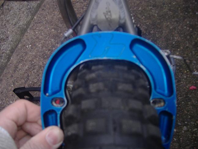

aener Posted October 11, 2007 Author Report Share Posted October 11, 2007 (edited) Grind the bit of your tyre that rubs?Might just have to.I wanted to be unique with a V on a mod.. Sorry.... Too late have you got any pics of the problem ?...And that's with it sitting ontop of the bolts!adding some spacers under adaptors and/or boosterI already did. This picture is taken with the booster ontop of the bolts though. Heatsink doesn't fit either:But THEN, I found a small gift from God, in the form of rollerblade bearings.The bit that sits inside the wheel, between the two cartridges, is almost a PERFECT M6/7 spacer.So now it's REALLY tall Be a man and grind away the problem.Thanks for your... er.... macho-input So I'm all sorted for now lads - cheers for all your input.I love how friendly other riders are - wether it's real life or not EDIT: Pagie - my cable's fine... it's the booster I'm on about.Also - sorry for uber-blurry pictures... One arm in a cast - so only one to use camera with.... Not a very good camera either Edited October 11, 2007 by Flipp Quote Link to comment Share on other sites More sharing options...
Zordon Posted October 11, 2007 Report Share Posted October 11, 2007 It looks like you could extend the bolts' holes in the adaptors a bit so the whole brake together with the booster will move upwards and make some more room for the tyre. Quote Link to comment Share on other sites More sharing options...
