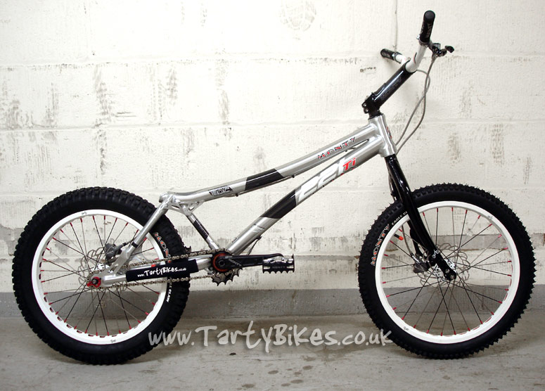

JT! Posted September 16, 2007 Report Share Posted September 16, 2007 (edited) See the red thing, that's the cam. And the black dot is the bolt. You can see how the cam is spiral shaped, so as you push down on the little handle (which is sticking out the back) the distence between the axel and the bolt becomes bigger, therefor forcing the wheel back.Let me know if you still don't get it. Edited September 16, 2007 by JT! Quote Link to comment Share on other sites More sharing options...
