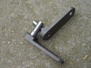

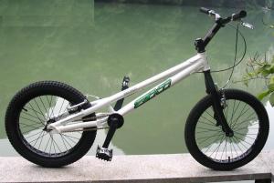

modman Posted August 21, 2007 Report Share Posted August 21, 2007 hey guys and girls,I've become fed up with my magura on my mod, it sucks. so i want rid of it. anyways just saw recently that one of the new ZHI bike has vee brakes on it and it clicked!! so yeah i was wondering if anyone knew where i could get hold of those vee adapters on that ZHI bike i'll find a pic actually.aha here it is!!so yeah anyone with any info would be greatly appreciated.thanks,jake Quote Link to comment Share on other sites More sharing options...

basher Posted August 21, 2007 Report Share Posted August 21, 2007 Heatsinks will work on a mod, why wouldnt they. And onza adaptors arnt sold seperately and arnt as strong as heatsink. Quote Link to comment Share on other sites More sharing options...
that NBR dude Posted August 21, 2007 Report Share Posted August 21, 2007 The Heatsink 4Bolt-Vee Brake adaptors have 3 levels of adjustment, so you can match them to any frame width or pad size, so you can always get the best set-up. I know plenty of people who run them and are very happy with them. click here for more information Quote Link to comment Share on other sites More sharing options...

Felix Posted August 21, 2007 Report Share Posted August 21, 2007 I don't want to ruin your hopes, but in most cases homemade adapters will be the only choice if you want to use Vees on a mod.Heatsink, Zhi or Bonz adapters move the brake mount closer to the axle and thus decreases the vertical clearance. This causes big mod rear tires to run on the cable. Ideally the mount should be located at the bottom hole of the 4-bolt mounts. Quote Link to comment Share on other sites More sharing options...
modman Posted August 21, 2007 Author Report Share Posted August 21, 2007 I knew that'd be the case anyway, thats why i posted a topic about it, but i know the ZHI ones fit as theres a picture of them fitted to a mod. Quote Link to comment Share on other sites More sharing options...
Smallville Posted August 21, 2007 Report Share Posted August 21, 2007 Try these http://zhibikes.com.ua/adapters.html they should be great dealing with, just give them a mail and they help you out on english. Or these site http://www.biketrial.co.nz/_sgg/m3_1.htm . Or this one, I have ordered from these guys one time and they are god http://www.zhibike.cz/E_katalog.htm Quote Link to comment Share on other sites More sharing options...

Zordon Posted August 21, 2007 Report Share Posted August 21, 2007 (edited) but then you would just have the same problem with stock in theroy as people use 2.5 tyres on stock aswell just like mod so really there shouldnt be a problem.You cannot compare it like this. 2,5 on mod is much bigger than 2,5 on stock.I'm using mielec vee adaptors on Gu 06 frame with Avid Ultimate calipers and half worn Try-All stiky tyre on 48mm rim and unstretched chain. Vertical clearance is fine, should be enough for a new Stiky tyre with full tread, not sure about bigger tyres like maxxis or monty 2,7 though. I removed the adjusting washers from the inner sides of the brake pads (coustvees, quite thin backings, comparing to plazmatic ones) and put one or two regular 1mm ones so the pads contact the rim flat and I don't rub the brake arms with my legs. Edited August 21, 2007 by zordon Quote Link to comment Share on other sites More sharing options...
Janson Posted August 22, 2007 Report Share Posted August 22, 2007 I don't want to ruin your hopes, but in most cases homemade adapters will be the only choice if you want to use Vees on a mod.Heatsink, Zhi or Bonz adapters move the brake mount closer to the axle and thus decreases the vertical clearance. This causes big mod rear tires to run on the cable. Ideally the mount should be located at the bottom hole of the 4-bolt mounts.How are these mounted to the bottom hole of the Magura mount? Is it just one long M5 bolt through the adapter and the brake? Maybe something more clever? Quote Link to comment Share on other sites More sharing options...
ben_travis Posted August 22, 2007 Report Share Posted August 22, 2007 Hello ladies....Well to shut people who dont know what they are sayin in this topic up, here is my 2 pence.I have had my heatsink v-brake adapters on both my stock and my mod, work fine, no clearance issues i can see as yet.I have a CZAR stock and CZAR mod with the v-brakes on the rear. there are 3 bolt holes on the bottom of the adapters so that these can be 'adapted' to fit all sorts of frame.Im not even going to start on how well made they are....but i would recommend themcheersben Quote Link to comment Share on other sites More sharing options...

eskimo Posted August 22, 2007 Report Share Posted August 22, 2007 The zhi ones look exactly the same as the heatsink ones. And as for the adapters i had no problems with them either.But damn that bike looks really really nice. Quote Link to comment Share on other sites More sharing options...
