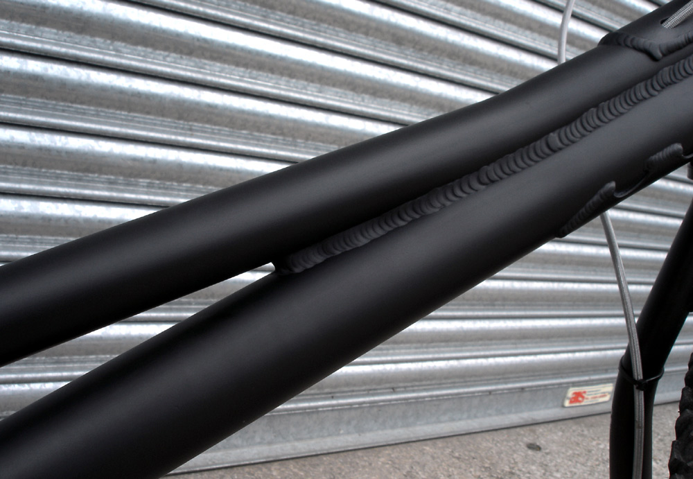

Davetrials Posted August 16, 2007 Report Share Posted August 16, 2007 Ah, well, I pretty much removed the whole end of the top tube, so the cable came out without any sort of struggle...sorry i dont understand this, u removed the top tube Quote Link to comment Share on other sites More sharing options...
Danny Kearns Posted August 16, 2007 Report Share Posted August 16, 2007 sorry i dont understand this, u removed the top tube As far as i am aware. He's cut a hole into the head tube or something. Then he's drilled into his frame somewhere else.Danny. Quote Link to comment Share on other sites More sharing options...
Pauly Posted August 16, 2007 Report Share Posted August 16, 2007 looks amazing and fair play to what you have done !in regards to the weight bit that people are crying over... if you dont brake parts then fair enough ... and lets be ohnest you have a whole shop full of stuff so it dosent realy matter haha Quote Link to comment Share on other sites More sharing options...
Waddy Posted August 16, 2007 Report Share Posted August 16, 2007 he means at the end of the top tube by the back wheel, where there is a little bung/plate welded on he cut it out, so when he fed the hose through a hole further up the top tube by the headtube the hose came out the end easy as its a big hole probably makes no more sence..... Quote Link to comment Share on other sites More sharing options...

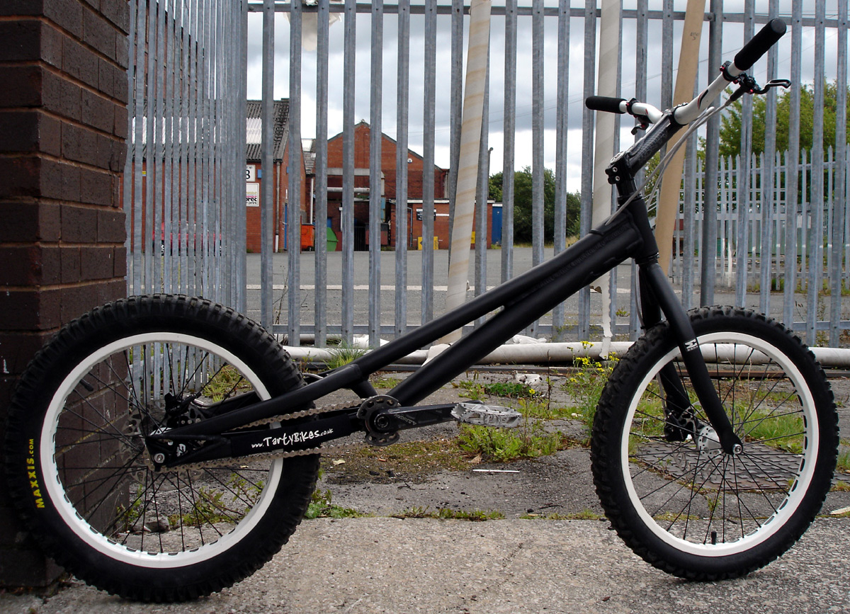

twentyinch Posted August 17, 2007 Report Share Posted August 17, 2007 Pictures of frame in daylight.... curious to see how this anodising looks!! Quote Link to comment Share on other sites More sharing options...
AdamR28 Posted August 17, 2007 Author Report Share Posted August 17, 2007 Very good! Steve's done an excellent job... Quote Link to comment Share on other sites More sharing options...
Nick Garland Posted August 17, 2007 Report Share Posted August 17, 2007 Looks Lush Ad. Liking the headtube mod, how much did you save in each area roughly?Does it make it rider better Quote Link to comment Share on other sites More sharing options...
Conor the basher. Posted August 17, 2007 Report Share Posted August 17, 2007 Very good! Steve's done an excellent job...WTF that is sooooo sick :) i love it lol i wana ride it Quote Link to comment Share on other sites More sharing options...
twentyinch Posted August 17, 2007 Report Share Posted August 17, 2007 Cheers adam!it looks amazing.. theres a local place near me than can do the anodising plus i presume they will do the shot blasting aswell..thing is.. Ours steeds will look the same pretty much... apart from... brakes, forks headset and rear hub....i hope you wont be pi**ed!! You can say you did yours first! CoolCheers chris.. Quote Link to comment Share on other sites More sharing options...
AdamR28 Posted August 17, 2007 Author Report Share Posted August 17, 2007 Looks Lush Ad. Liking the headtube mod, how much did you save in each area roughly?Frame and bash, as new = 2044g Frame no bash, saved 142gNo paint, saved 42gBashplate mounts off bb shell/downtube, saved 22gBashplate mounts off stays, head tube hole, one yoke plate machined out, saved 43gHole in top tube, other yoke plate machined out, general tidying, saved 16gCorners off the rear dropouts off, general filing to bashplate mounts, saved 14gMore filing and grinding to various bits, saved 8gHead tube ring reinforcements removed, saved 5gFaced/reamed headtube and BB shell, saved 2gLarger holes in dropouts, more head tube work (breathe holes into top and down tubes), scoop on BB shell, saved 15gShot blasting and anodising, saved 14gTotal saving 323g thing is.. Ours steeds will look the same pretty much... apart from... brakes, forks headset and rear hub....i hope you wont be pi**ed!! You can say you did yours first! Haha, not a problem Look forward to seeing how it turns out mate! Quote Link to comment Share on other sites More sharing options...
Steve H Posted August 17, 2007 Report Share Posted August 17, 2007 Adam that is class, really love the stealth look frame with the white.Tempted in getting a czar now Steve Quote Link to comment Share on other sites More sharing options...
BenLeacock™ Posted August 18, 2007 Report Share Posted August 18, 2007 (edited) i thought the monty was nice but this is just...... amazing ! the black looks nice with the white, the hole think looks class !! ur soo lucky ... hopefully this will last longer than the monty!! ( meaning you will keep it longer ) im lost for words Edited August 18, 2007 by benleacock Quote Link to comment Share on other sites More sharing options...
