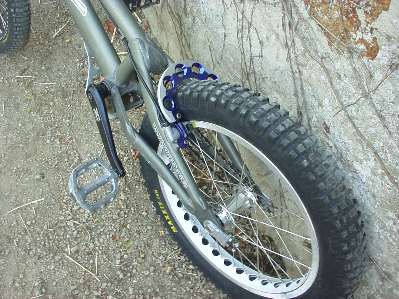

Alex-Mitchinson Posted August 8, 2007 Report Share Posted August 8, 2007 (edited) Well, I was bored so I decided to re-design my booster a little. It was a blue GU 4 bolt, it is now a half blue half silver 2bolt! Woohoo.Took me aaaaages to sand the anodising off, then cut the bottom of each side off and filed down to make lovely and smooth.At least it's different, comments please...... Edited June 2, 2008 by Alex-Mitchinson Quote Link to comment Share on other sites More sharing options...
Jed Posted August 8, 2007 Report Share Posted August 8, 2007 (edited) Look's fit. Just doesn't really go with the frame, spray the bike! Edited August 8, 2007 by quizzin Quote Link to comment Share on other sites More sharing options...
Alex-Mitchinson Posted August 8, 2007 Author Report Share Posted August 8, 2007 Look's fit. Just doesn't really go with the frame, spray the bike!The silver does, not sure about spraying the frame really. I would prefer to just strip the paint off but I cant because it's powder coated Cheers for the comment Quote Link to comment Share on other sites More sharing options...

AdamAllen Posted August 8, 2007 Report Share Posted August 8, 2007 (edited) Why not ?AdamWhy convert a 4bolt booster to 2 bolt if you have a 4 bolt brake? thats what i don't get... i can understand getting rid of the colour.AdamP.s Caustic soda will make the job ALOT easier.. Edited August 8, 2007 by econtrol Quote Link to comment Share on other sites More sharing options...
Nick Garland Posted August 8, 2007 Report Share Posted August 8, 2007 To save the tinest bit of weight maybe. My back end on my Czar is solid and doesnt need a booster, I run one to stop me snagging the cross over. Maybe he is doing the same and removed the part he didnt need.Looks ok, would look better with a different colour frame as someone else said Quote Link to comment Share on other sites More sharing options...
Caleb Posted August 8, 2007 Report Share Posted August 8, 2007 you dont get as much clearance with a 4 bolt booster on a mod2 bolt are eaier to adjustlook neater etc . . good job that pal, and that t-pro looks like new !, v nice Quote Link to comment Share on other sites More sharing options...

poopipe Posted August 8, 2007 Report Share Posted August 8, 2007 I would prefer to just strip the paint off but I cant because it's powder coated no it isn't, it's anodised(assuming it's a t-pro) Quote Link to comment Share on other sites More sharing options...
JD™ Posted August 8, 2007 Report Share Posted August 8, 2007 no it isn't, it's anodised(assuming it's a t-pro)*agrees* just use the caustic soda this time! Quote Link to comment Share on other sites More sharing options...
Alex-Mitchinson Posted August 8, 2007 Author Report Share Posted August 8, 2007 no it isn't, it's anodised(assuming it's a t-pro)*agrees* just use the caustic soda this time! Ok yeh I meant anodising then, tried caustic soda but didnt work, possibly because I used a weak soultion. I cut it down to 2bolt because I never actually used to use the top 2 bolts in the booster, just the bottoms other wise it was too stiff, but the main reason I did it all is because it different!And yes caustic soda would have worked on the booster but it would of taken all the blue off, I wanted half blue half silver, becuase there is a little ridge between the blue and silver it meant that the sandpaper didnt touch the bottom, thus leaving a neat line between the two colours. Quote Link to comment Share on other sites More sharing options...
