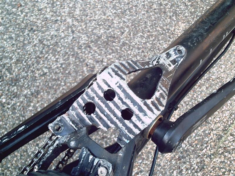

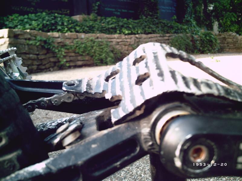

Ryan. Posted August 4, 2007 Report Share Posted August 4, 2007 when i got this frame the bash was already on the verge of this happening and me being a fool didnt bother getting a bash ring for mty cranks so its either uci *** from now on or somehow get the freewheel off or could get new cranks Quote Link to comment Share on other sites More sharing options...

Ryan. Posted August 4, 2007 Author Report Share Posted August 4, 2007 joewhite said: yer. allen keys take the bash off you buy a new one and put it back on. haha! never thought that might be the easiest option?before you get all arsey. if you had bothered to read my post you would have seen that i said the bash was "bent" which stopped me from taking the bolts out as it was at such a great angle. Quote Link to comment Share on other sites More sharing options...

eskimo Posted August 5, 2007 Report Share Posted August 5, 2007 Rip the bolts out and helicoil them. Then get a new bash. If you have the effort that is.. Quote Link to comment Share on other sites More sharing options...
Ryan. Posted August 5, 2007 Author Report Share Posted August 5, 2007 the bolt snapped right against the frame? any ideas on removing it? Quote Link to comment Share on other sites More sharing options...
monty boi Posted August 5, 2007 Report Share Posted August 5, 2007 Blowtorch the bolts then try i did this with my cranks on my old bike, it worked.Adam. Quote Link to comment Share on other sites More sharing options...
ManxTrialSpaz Posted August 5, 2007 Report Share Posted August 5, 2007 Sheringham_trials said: the bolt snapped right against the frame? any ideas on removing it?Could get it tapped? LBS might do it for you....maybe Quote Link to comment Share on other sites More sharing options...
Tailz222 Posted August 5, 2007 Report Share Posted August 5, 2007 You can do what i've done, i've taken the bash plate off and cut the mounts off so u hav a smooth tube and dont run bash plates at all, only use a bash ring.makes you a smoother rider gettin up things not relying on your bash plate Quote Link to comment Share on other sites More sharing options...
Guest Posted August 5, 2007 Report Share Posted August 5, 2007 Drill the bolts out using a good strong steel drill, you don't want a very sharp drill as that won't be easy to control, a blunter drill will cut slower and allow you to stop and start. try and remove as little aluminium as possible, if any at all, and then tap the hole's a thread size bigger, take it slow, and make sure that the new bolts you puit in arn't too long, otherwise they will end up breaking inside and your back to square one. (believe me that is f**king annoying) Quote Link to comment Share on other sites More sharing options...

Muel Posted August 5, 2007 Report Share Posted August 5, 2007 Chop as much of the bash away with an angle grinder, that should relieve any tension it it and you should be able to get them undone.Thats what I had to do on my last one. Quote Link to comment Share on other sites More sharing options...
Guest Posted August 5, 2007 Report Share Posted August 5, 2007 KuelMuel said: Chop as much of the bash away with an angle grinder, that should relieve any tension it it and you should be able to get them undone.Thats what I had to do on my last one.He can't do that on at least one of them as the bolt has no head. Quote Link to comment Share on other sites More sharing options...
Ryan. Posted August 5, 2007 Author Report Share Posted August 5, 2007 Jakers said: He can't do that on at least one of them as the bolt has no head.what he said i think i may just get a bash ring? Quote Link to comment Share on other sites More sharing options...
Muel Posted August 5, 2007 Report Share Posted August 5, 2007 But it would help though.You only need the head on the front bolt, on most frames you can get at the rear bolts from the other side.What we did on my mates T-Mag was to chisel the soft bash away from the bolt, as it was seased and stripped the head, and clamp it with mole grips once all the bash material was filed/bent/chiselled away. Quote Link to comment Share on other sites More sharing options...
aener Posted August 5, 2007 Report Share Posted August 5, 2007 Sheringham_trials said: the bolt snapped right against the frame? any ideas on removing it?Get one of the old, rounded-off alan keys.Superglue it to the bolt, and let it set.Unscrew and become unskrewed. Quote Link to comment Share on other sites More sharing options...
