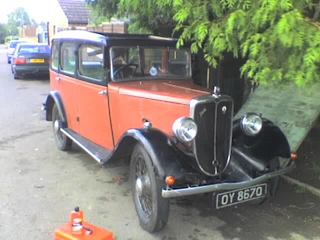

fathopper Posted July 13, 2007 Report Share Posted July 13, 2007 (edited) http://imageshack.us]http://img165.imageshack.us/img165/8900/0107072022zr9.jpgRight heres the situation, Ive just downloaded a trial for adobe photoshop cs3, and want to do some simple colour changing of a photo, this photo hereSo how would I go about changing the maroony colour using photoshop? To sat green or blue or any colour?Please Helphttp://imageshack.us][img=http://img165.imageshack.us/img165/8900/0107072022zr9.jpgShot at 2007-07-13 Edited July 13, 2007 by fathopper Quote Link to comment Share on other sites More sharing options...

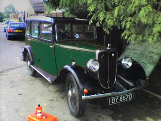

James Quigley Posted July 13, 2007 Report Share Posted July 13, 2007 (edited) Lasso tool - Colour/hue/saturation adjustments ?Maybe a bit of brightness/contrast adjustment too.All adjustments once lassoed will be in the menu's up top.Edit: Here's a very, very, very, very quick example......... Edited July 13, 2007 by ReverendJQ Quote Link to comment Share on other sites More sharing options...

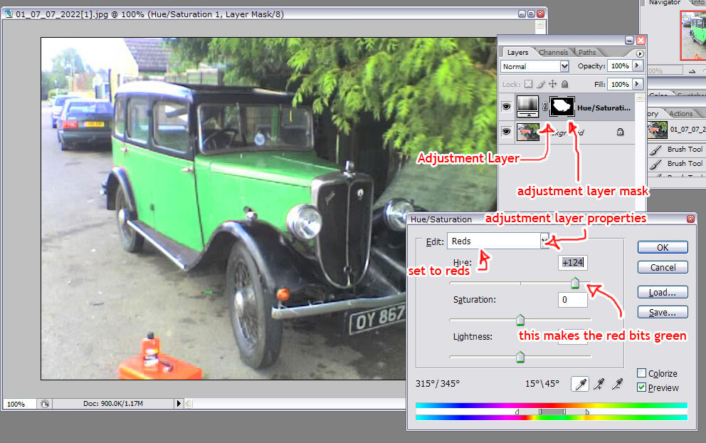

poopipe Posted July 14, 2007 Report Share Posted July 14, 2007 (edited) this way is totally non-destructive.make a hue/saturation adjustment layerset it to work on redsset the hue to whatever colour you likepaint out the bits you dont want the colour changed on in the adjustment layer's layer maskvoila - 30 seconds.oh sorry - didnt see the cs3 bit. I'd have used that instead for the screenshots. same stuff applies Edited July 14, 2007 by poopipe Quote Link to comment Share on other sites More sharing options...
