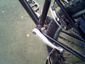

Looking at this picture of my frame (Iolo) I think I get the idea, the chainstay would extend right to the BB so it has to be wider to join on. (I'm pretty slow to understand mechanical things)
Now I understand why my frame had to have a 73mm shell. That was such a pain finding a long enough BB to make my chainring clear the frame! Hence spacer/cable tie bodge in that picture to push it out... (Now I have 73 x 127 UN54)
