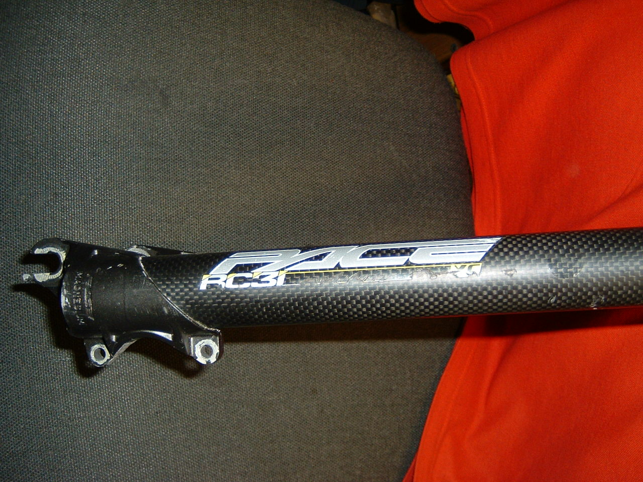

Waynio Posted July 3, 2007 Report Share Posted July 3, 2007 iv got a set of pace ones, 380mm from dropout to crown (which is quite short) this does limit the flex in the forks.iv got mine for sale if anyone wanted them, they would probably fit a mod pretty well, and a stock it does shorten the wheelbase a little bit (which in some cases works quite well!!!)with anything carbon you just have to be "carful" dont go bashing them round like you would an ally set. mine have been fine after i had a new disc dropout put on as i ran a 200mm rotor when the forks are only designed to run a 160mm.Wayne. Quote Link to comment Share on other sites More sharing options...

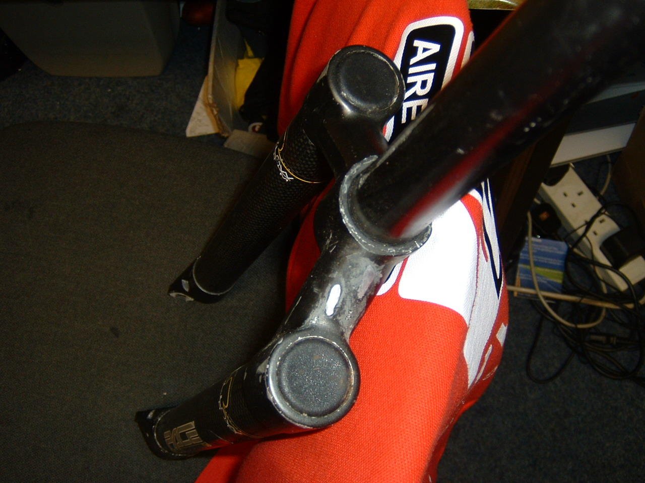

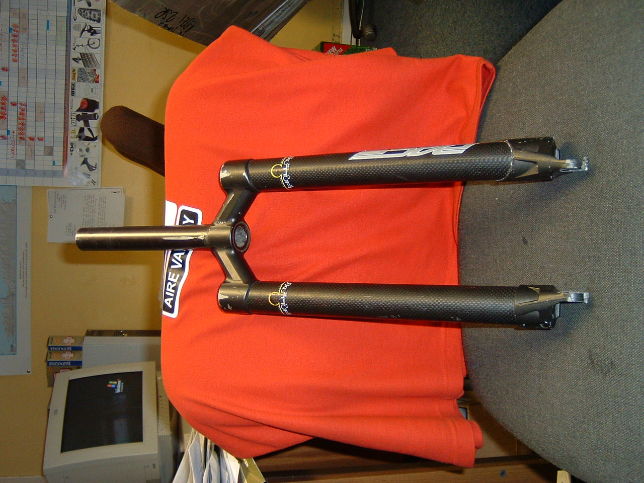

br3n Posted July 3, 2007 Report Share Posted July 3, 2007 (edited) I rode with pace rc250 or whatever the carbon fibre/magnesium xc forks are, the problem is theyre desingned to replace a single crown suspension fork - so theyre actually pretty tall.Theyre also really, really, really flexy.. which is horrible when tapping. Not to mention i cracked the disk mount within 2 months.edit: you can see how long they are below. Edited July 3, 2007 by br3n Quote Link to comment Share on other sites More sharing options...
