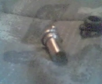

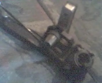

CurtisRider Posted July 20, 2007 Report Share Posted July 20, 2007 righty, finally looked, and both of mine seem to be rights but heres some pics explaining the deore bodge (well i say bodge, it makes it better)firsty, diassemble a deore calliper, you need to prise off the washer, then it all falls apartthen find the nice silver bit with the lug that sits in the tension mounts in your frame (excuse the wank photos, i had to use a webcam):get the hacksaw out and chop off the excess shaft, file to smooth so its the same as your old original internaland it'll fit in lovely like this:works the same, and its beefier being steel, ive never snapped a deore one the tension plates are the only week point on ultimates, tis a shameok that was the shittest how to guide ever, but i dont have time to go and find an old deore to mash up again Quote Link to comment Share on other sites More sharing options...

Onza Kieron Posted July 20, 2007 Author Report Share Posted July 20, 2007 Thanks very much for that Paul, I have a Deore caliper here now so I'll give it a bash, thanks very much, saved me loads of time and waiting. Quote Link to comment Share on other sites More sharing options...
