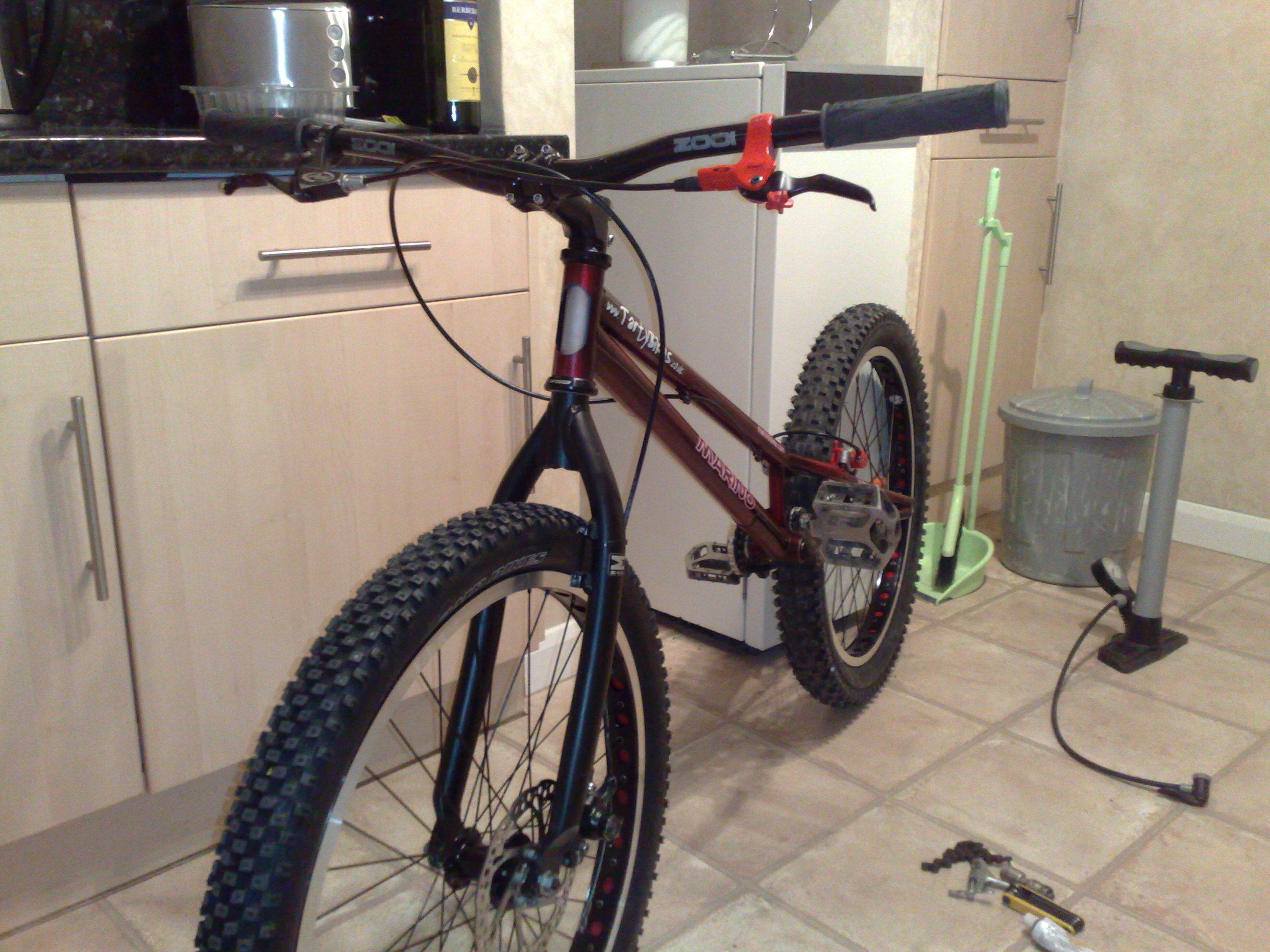

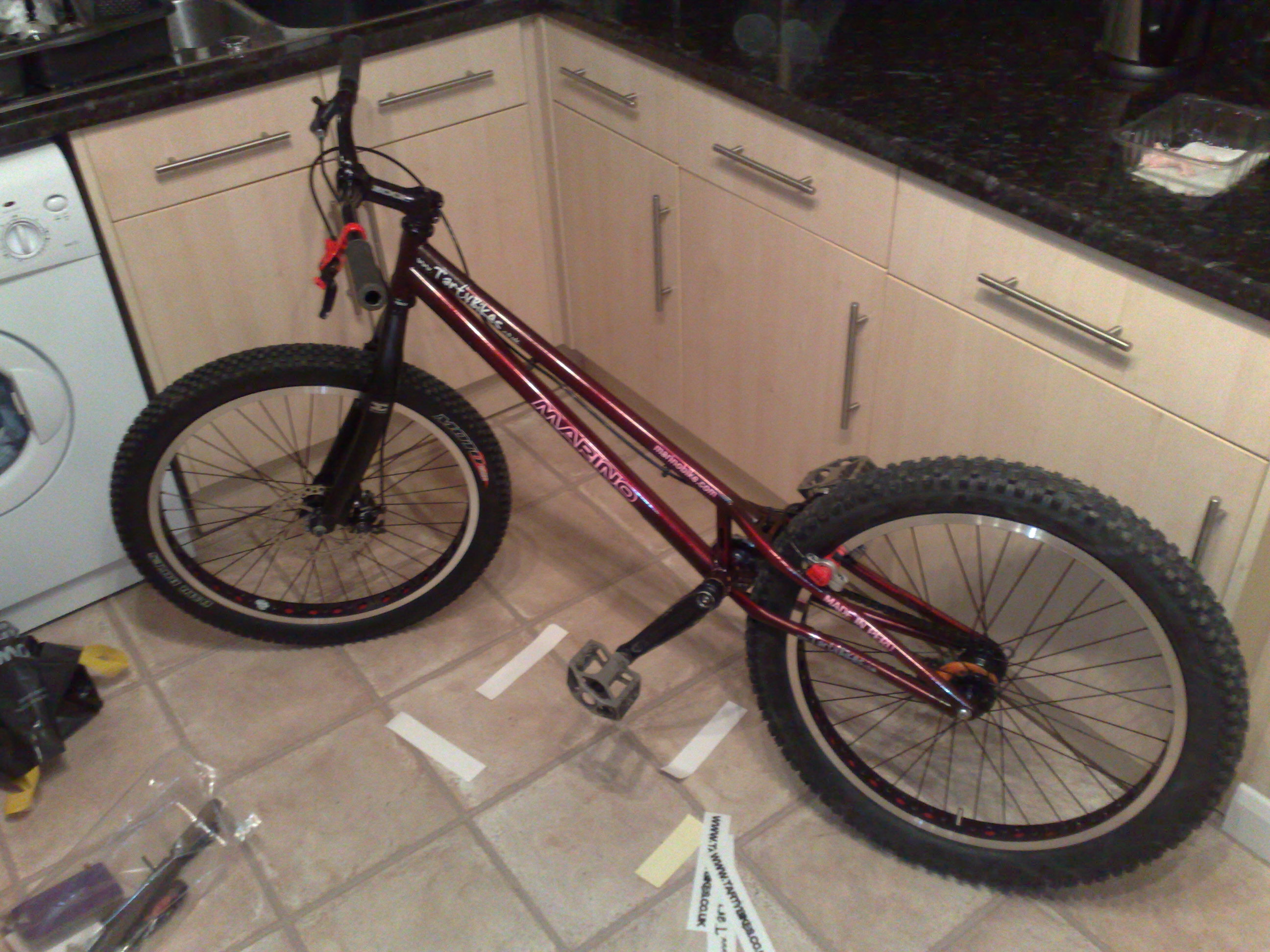

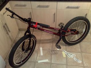

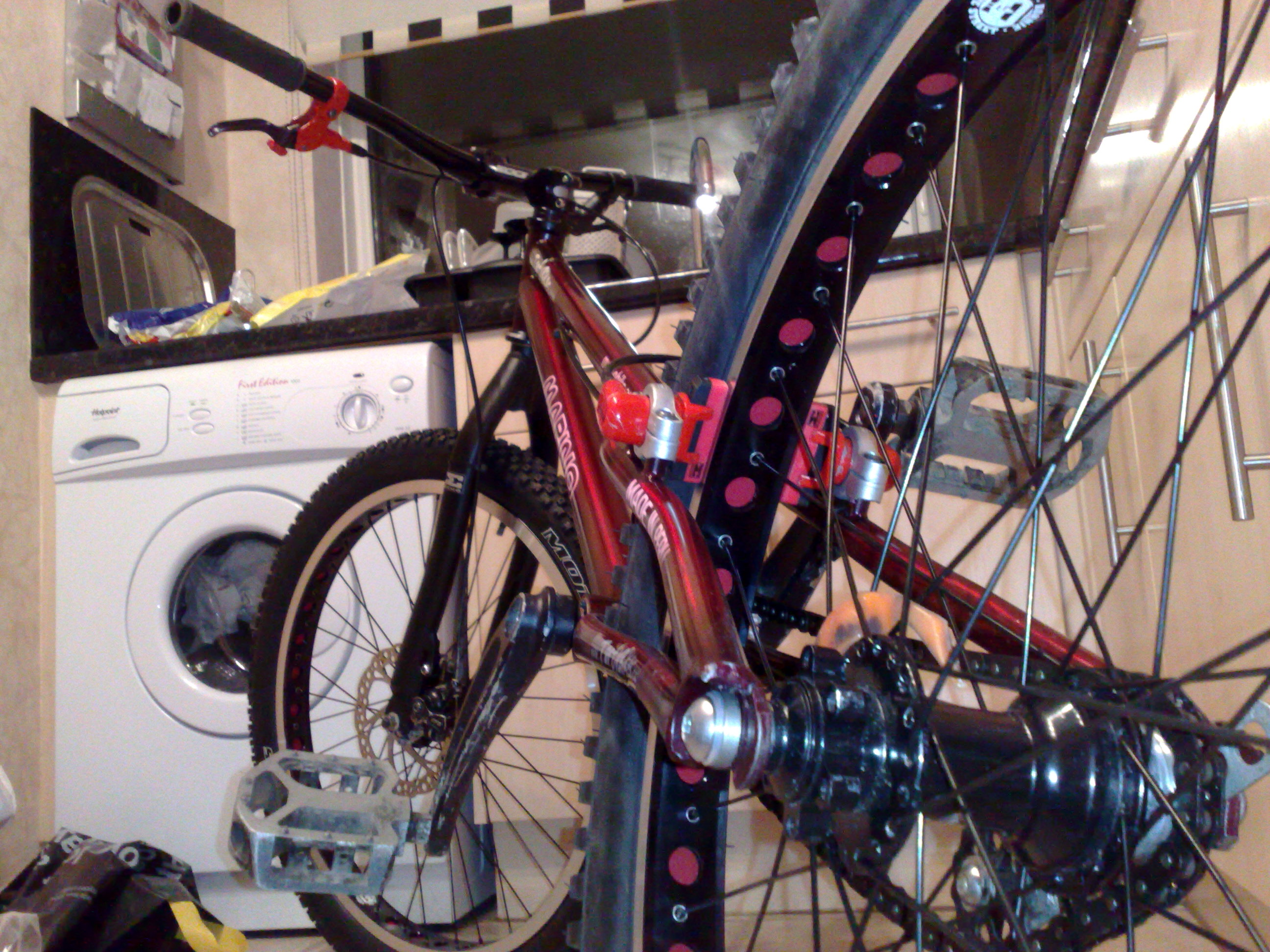

just got my new 24" all finished so i though i would share some pics, so you could let me know what you all think thanks

i haven't got my built yet but i will have tomoro when my parts come, i have 24"built by him and its awsome, cant find a fault with it buy looking at it, the welds look good, its nice and light and its got renforcing gussets/plates in all the right places and they all look really neat. i will put a pic up of it tomoro when its built
