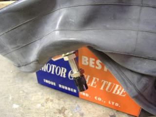

  2. I know you asked about 20", but just in case you meant rear mod (19"). These things rock. Thicker than normal bicycle tube, but not gnarly thick like you would think of old school motorcycle tube. Exactly the right size (no over inflating 20" BMX tubes). Metal threaded valve with lock down nut. Think www.trialsin.com has some.......... but that is a long way away to order a tube!
