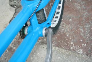

  6. It has a try all axle with shimano bearings, the axle is 22 mm diametre and the bearings are 24 so i made a pice on a lave, you can chose some bearings in general the ones used in bmx bikes who come in 22 mm. i have chosen this tipe becouse they are cheap and wanted to test the idea, next will use some campagnolo 50g a set and an titanium axle. so its will be light and rigid

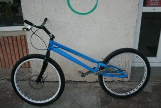

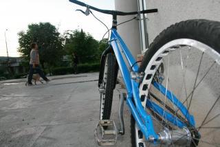

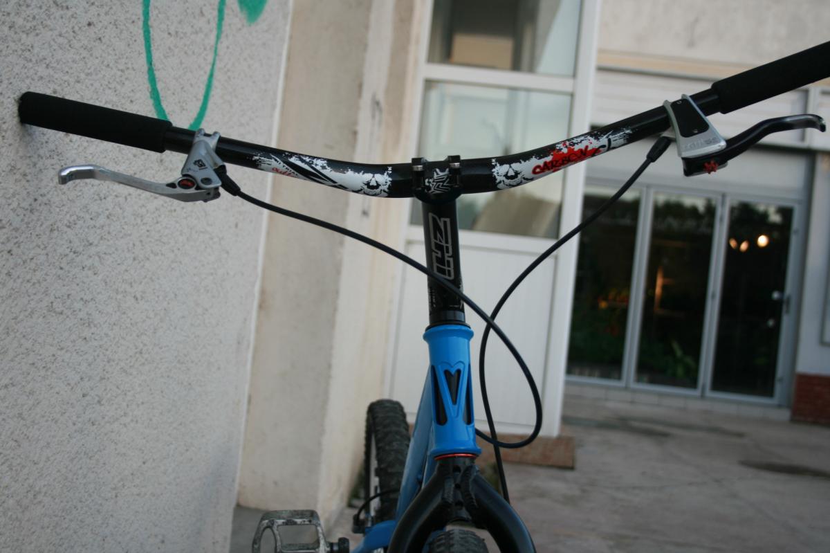

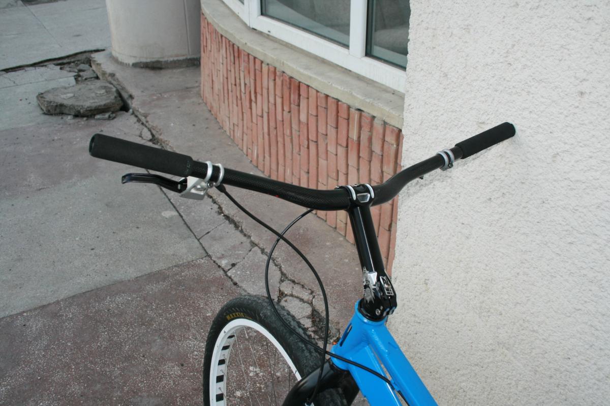

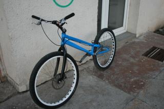

  7. The frame arived in standard black and i didnt like the idea of a black bike so got powder coated it in blue, didnt weight it as I want to change the tires , tubes and put some titanium on , Spec Neon sun( 7075 al) neon fork louise 2007 190 mm hs 33 tnn pads front try all rim on echo hub maxxis tyre rear echo cnc old model on chris king try all cranks with self made external bb zhi carbon handlebar zhi 2013 cnc 150x30 stem
