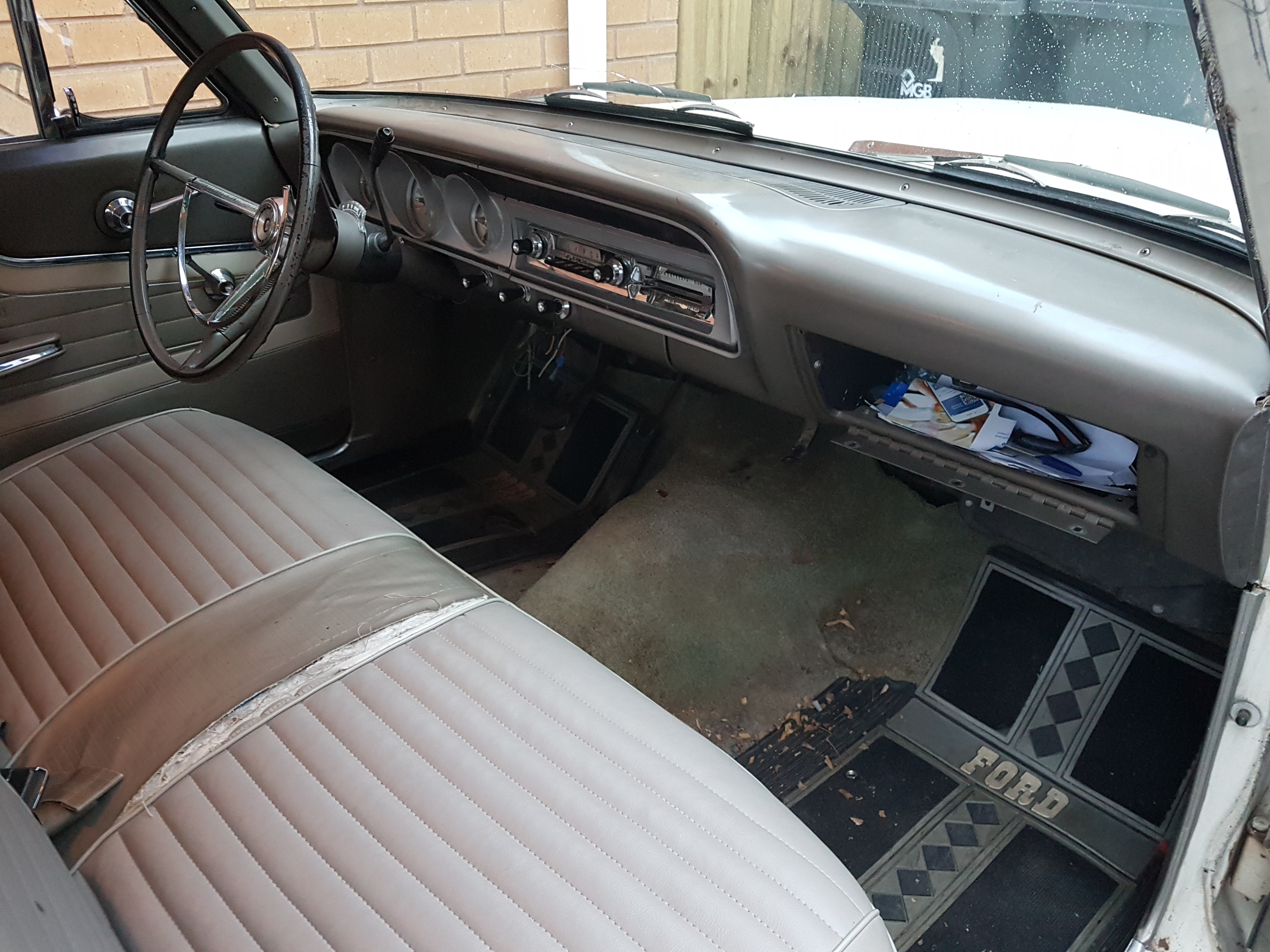

Yeah original front and back on the bench seats. I did wonder about getting them repaired but I don't know if it would be possible, it's not ripped the stitching it's ripped the material where it's stitched so I don't think there would be my strength left in the seam. Carpet will be going in winter for a new smoke grey moulded piece. Headliner is ripped too so I'm chucking a new one in when I do the window seals.
All those leaves came off the top.of the aircon unit. I've not cleaned it since I bought It shamefully. It'll be having a new carpet, headliner and seat covers over winter. I originally was gonna go for a turquoise interior with painted dash, doors and matching carpet the full works but since driving it I love the minor wear on the door tops and dash. It's took 50+ years to get there so why spoil it now, it's not like it needs painting.

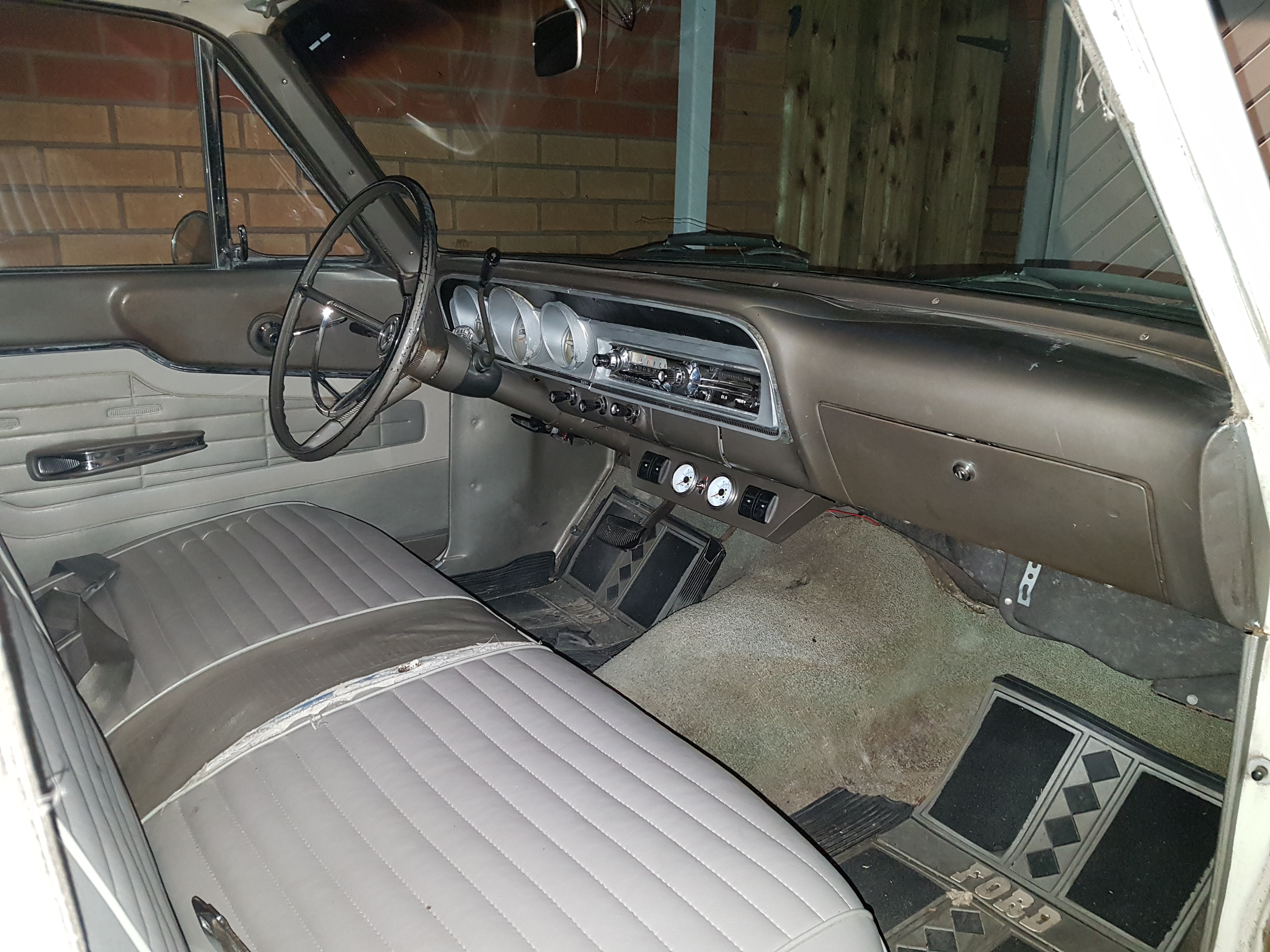

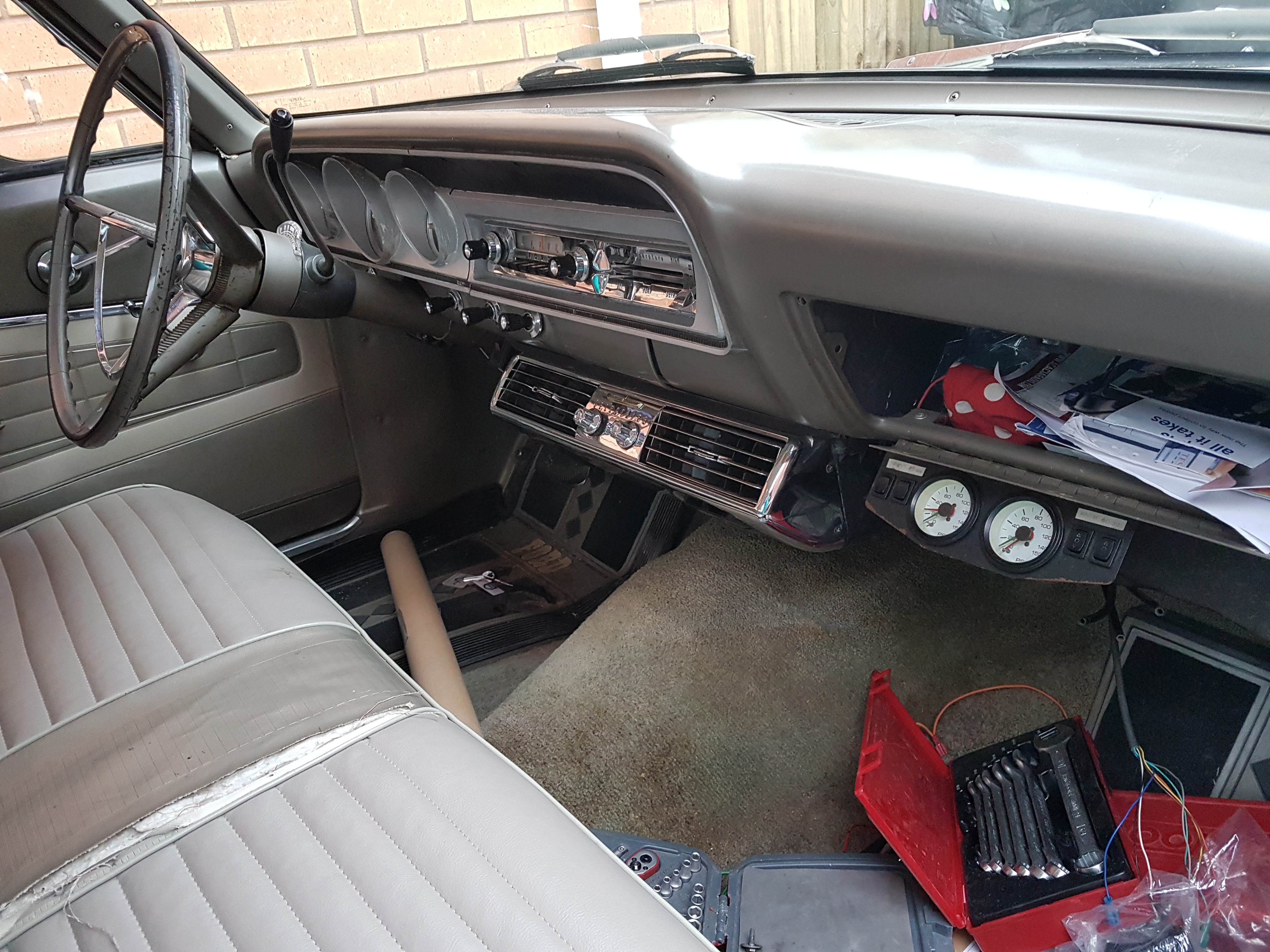

Before.... After.. Removed the old air ride controls as I'm going to paddle valves, today I'm making a nice new gauge/switch plate that'll hopefully fit in with the dash. Removed the factory aircon unit as I needed somewhere to put the air ride controls that was more convenient, air con didn't work anyway as someone has removed the aircon compressor in it's lifetime. Hopefully make for a nice tidy install. Found loads of shitty wiring too that's been added along the way so after an hour it's back to more or less a standard loom behind the dash. I do have the glove box door, its just off to colourmatch for the new panel.

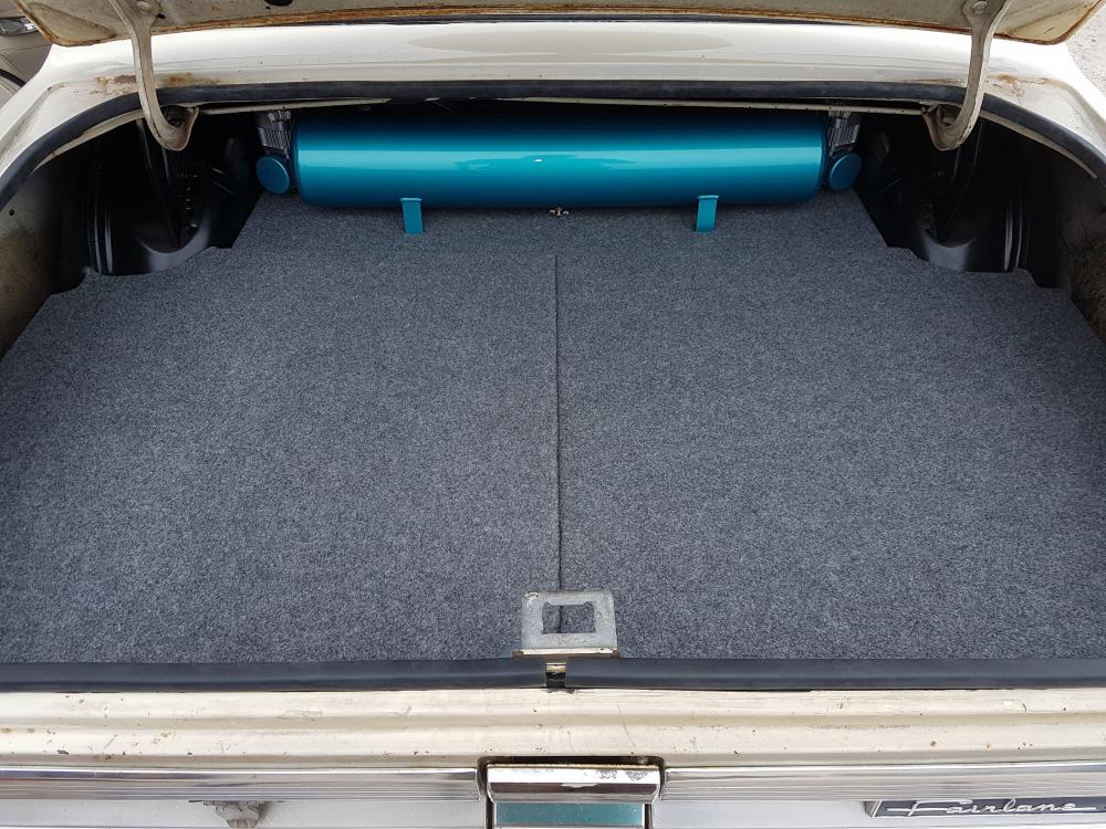

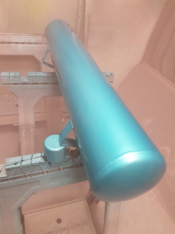

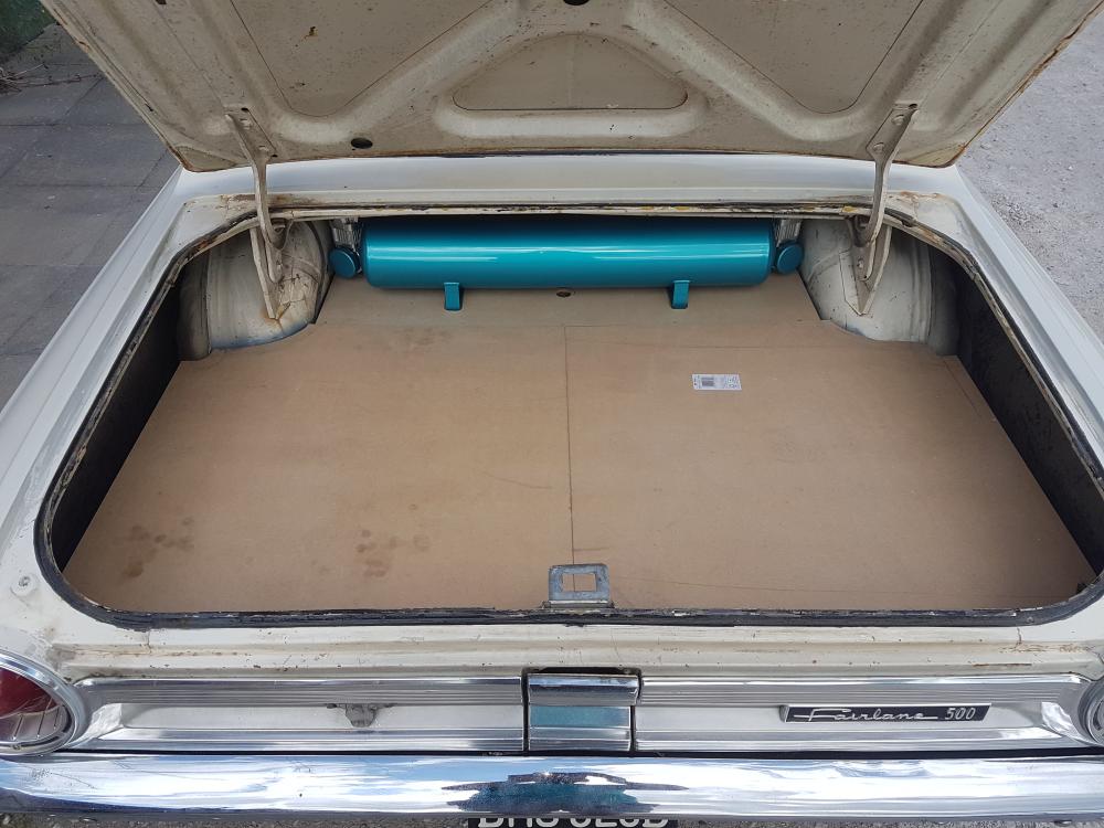

Air tank painted (Just realised it looks like a bloody Clarke air compressor tank ) Twin Viair 444c turned up today, ordered stainless pipe for the hardlines, all fittings and parts I'll need. I've ordered carpet for the boot build too. I can't decide wether to take the leap and just buy an Air lift V2 setup, but at the minute I think theres better things i could spend that money on.. Really looking forward to getting into this, shame I've got a wedding this weekend!

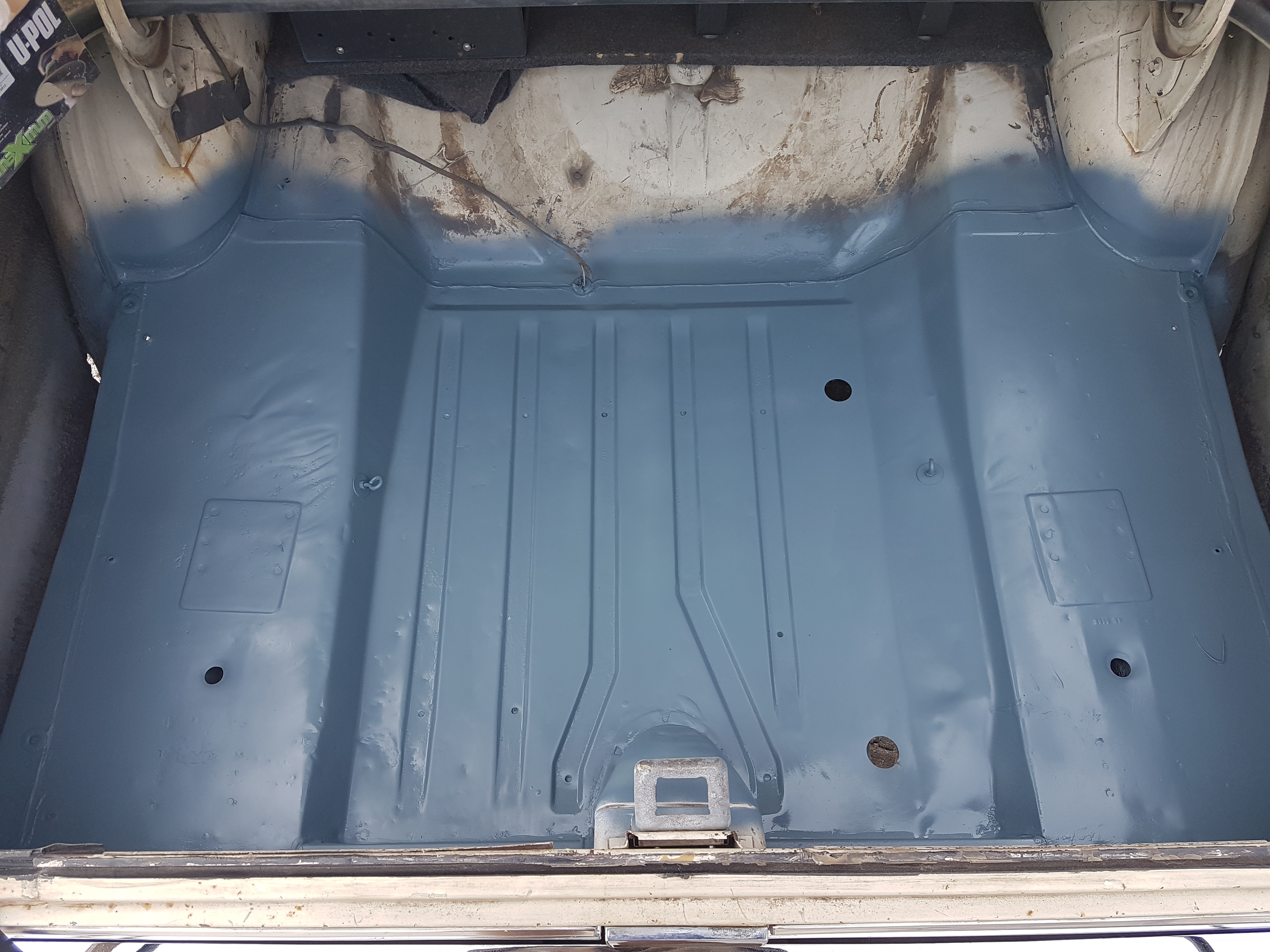

Bare metal, wet on wet etch primer and high build, I'll work the arch tubs and further up tomorow then colour all being well.

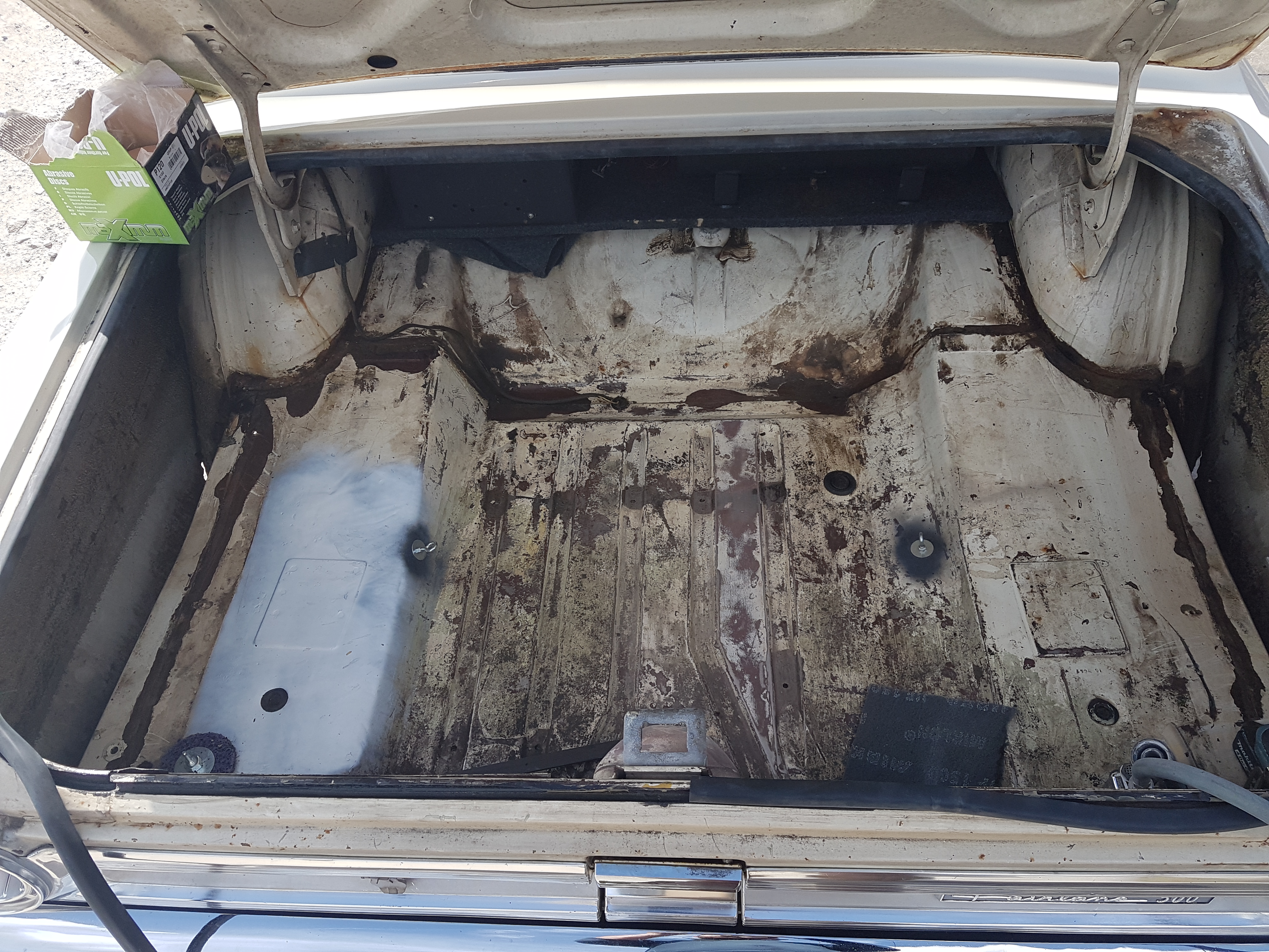

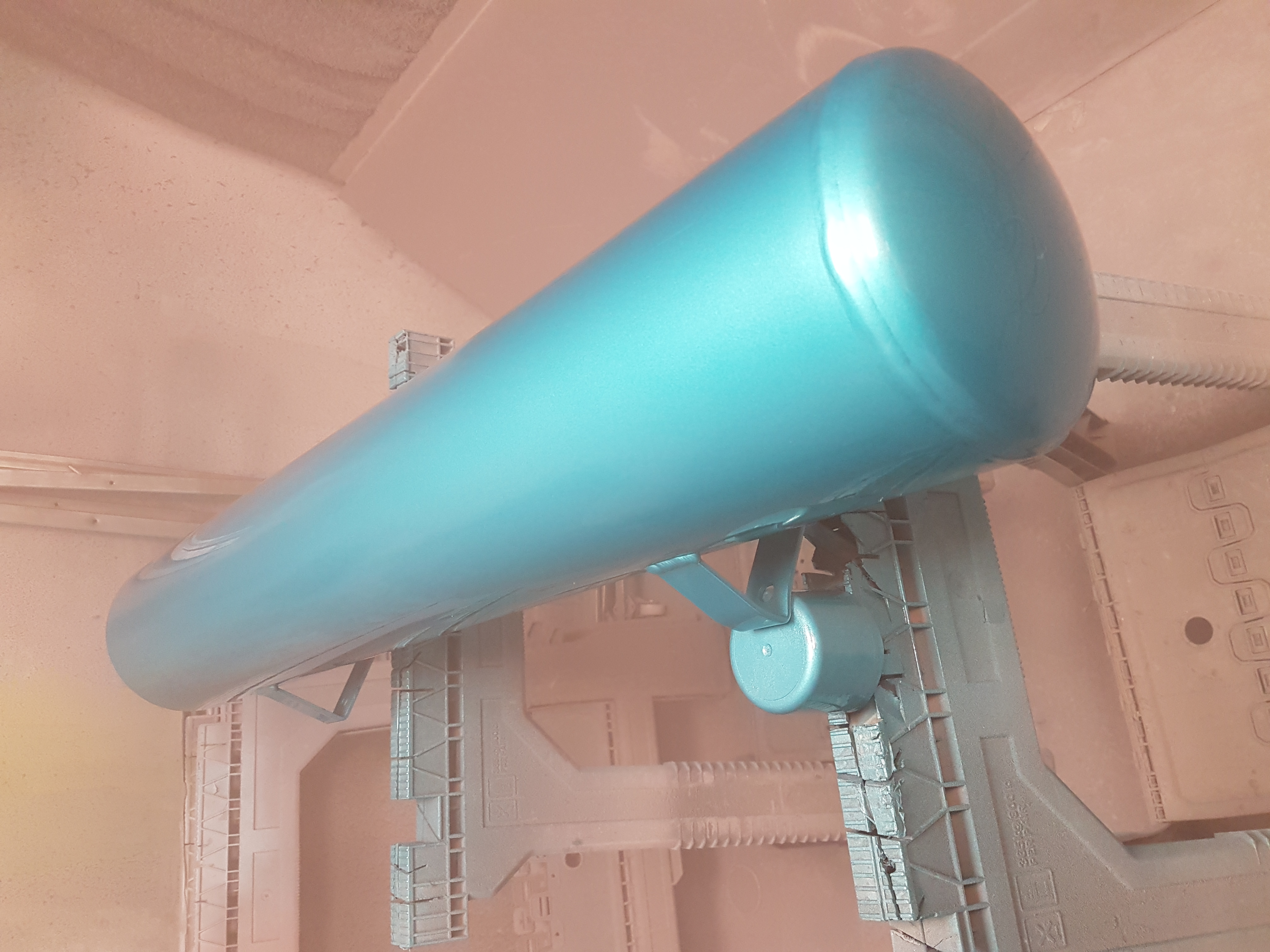

Why I love yank imports.. Other then the surface rust on the left I've got with a wire wheel and etch primed totally rock solid Just flagging back now with the DA then gonna put fresh colour on tomorow ready for the new air tank rebuild. I don't want a show stopping finish in there just nice and new fresh colour

Straight pipe it. Job done. Dual Viair 444c compressors and a 5gal tank ordered ready for me to start my boot build. It's currently on some turd of a tyre inflater and a 2gal tank that wipes out after 1 lift. I don't want loads of switch time but it's be nice to have some backup. Got a boot plan sorted to allow some tool storage aswell as the air ride tucked away to try and keep it quiet too. Hoping to fit digital management later on too, switches are simple but it's a twat to get them balanced.
